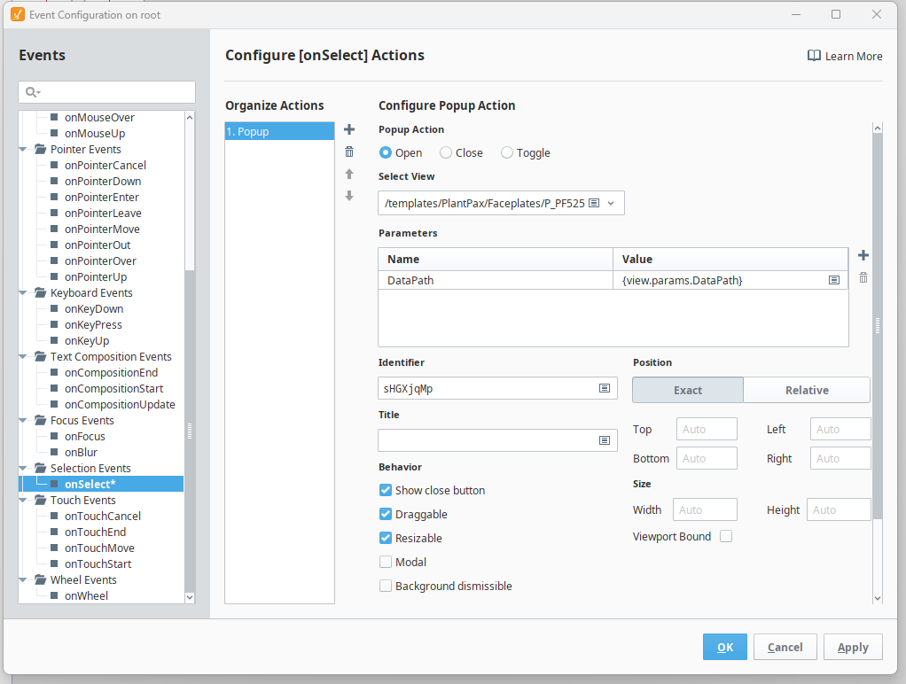

I created a template device for an analog input in which if you click on it brings up a faceplate popup. The event is placed on the root container. In action though this doesn't work and I am not sure why. I have tried the following:
- Using the OnClick Event
- Using the OnSelect Event
- Using different popup screens to ensure its not a faulty path.
- moving the objects in the template in order to click on the root container itself.
Nothing seems to work. Maybe I am using the wrong action or just have some sort of misunderstanding of how this should work?
 ![image](https://us1.discourse-cdn.com/inductiveautomation/original/3X/a/3/a3e2544590073fc79b1b1e6e5bd142002ec47a98.png)
**Post date:** [July 15, 2025, 2:26pm UTC](https://forum.inductiveautomation.com/t/ignition-perspective-root-container-events/108475/2 "2025-07-15T14:26:19Z")
Have you tried it in the browser? Popups don't work in Designer as its "browser" is limited to the view you're working on.
**Author:** ![jparsons1](https://avatars.discourse-cdn.com/v4/letter/j/f14d63/32.png) [@jparsons1](https://forum.inductiveautomation.com/u/jparsons1)\
**Post date:** [July 15, 2025, 4:34pm UTC](https://forum.inductiveautomation.com/t/ignition-perspective-root-container-events/108475/3 "2025-07-15T16:34:15Z")
Yeah you were right.
