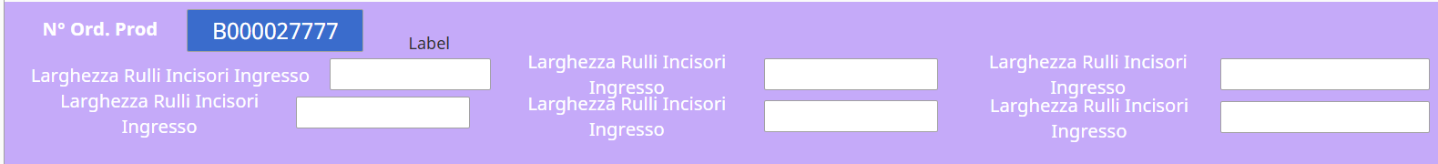

I have a **Flex root view** in Ignition Perspective that contains **three Coordinate Containers**.
The design screen size is **1600×800**.
**Issue:**
- On a laptop screen (smaller than 1600px width), both horizontal and vertical scrollbars appear.
- On a large monitor (1600px or more), the view displays normally.
**Goal:**
I want the entire view to **scale proportionally (zoom out)** on smaller screens and **return to normal size** on larger screens — similar to a zoomed canvas — without showing any scrollbars.
Thanks!
Actual large screen 1600x800:
 ![image](https://us1.discourse-cdn.com/inductiveautomation/original/3X/d/7/d7052a526f503fa2618f4055ed622b5a08fd0c6b.png)
In laptop screen :
 ![image](https://us1.discourse-cdn.com/inductiveautomation/original/3X/a/b/abf4714776839e16ad7cf57e05eed09c33306d8d.png)
**Post date:** [August 16, 2025, 10:44pm UTC](https://forum.inductiveautomation.com/t/ignition-perspective-zooming-flex-view-without-scrollbars/109849/2 "2025-08-16T22:44:05Z")
Question 1: Why are you using coordinate containers in the flex view? Make everything flex!
 ![image](https://us1.discourse-cdn.com/inductiveautomation/original/3X/c/0/c018e311dc43104dc5b9dbac534373cf4f9a35ce.png)
\*Figure 1. Two flex row containers inside the flex view. All labels and text / number fields set to.
 ![image](https://us1.discourse-cdn.com/inductiveautomation/original/3X/0/2/027e63173c890a6a5fa8d459bead9ca05ba27a57.png)
_Figure 2._

Thanks for the guidance — I’ll go ahead and implement it as you recommended.
