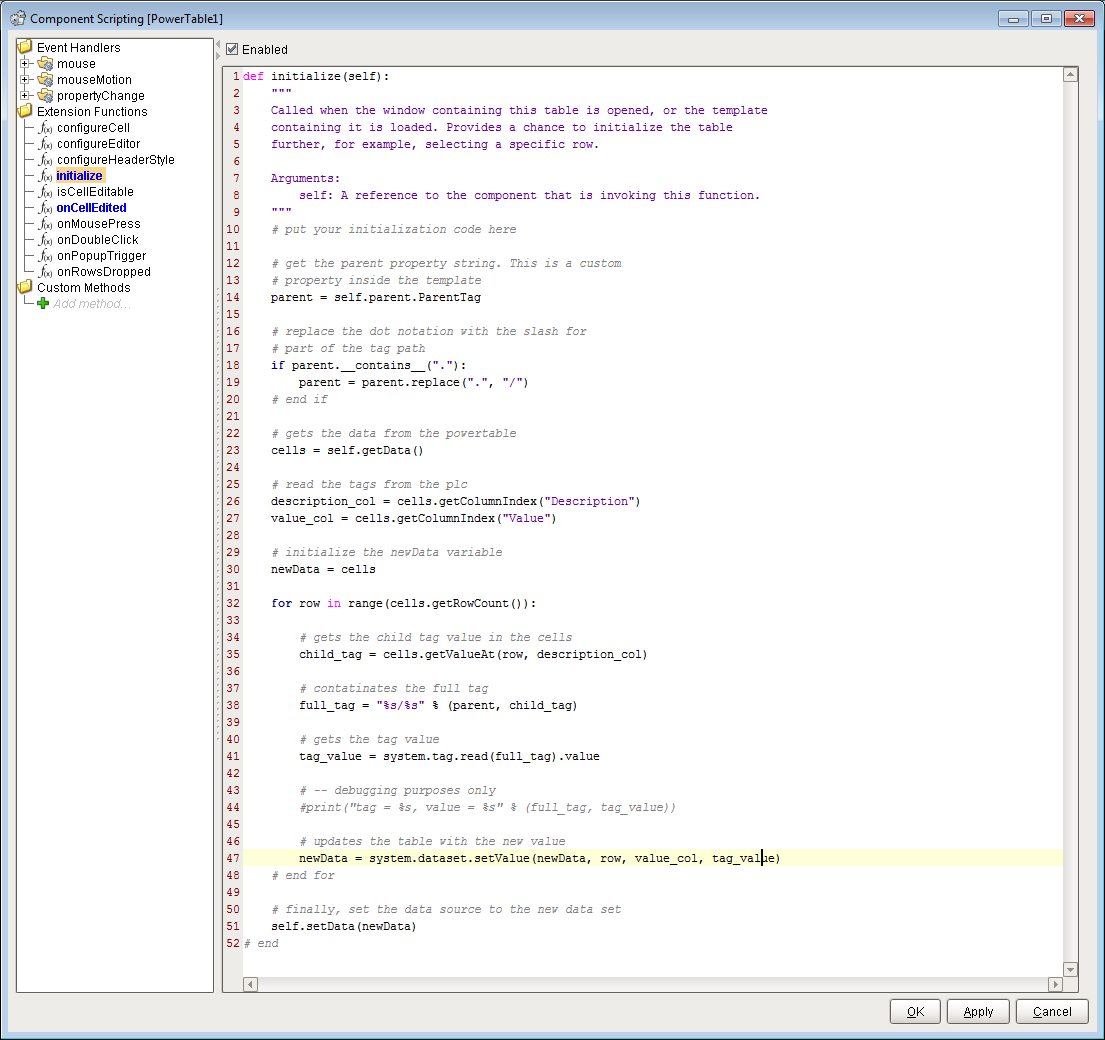

Hello, I am trying to do some scripting on a power table and I am having trouble. Basically, I want to have a table of “tags” that get read on the initial load. The first column of the table is the tag I want to read, and the second column in the table should be the value of each tag. Here’s my method:
 ![](https://us1.discourse-cdn.com/inductiveautomation/original/2X/a/a08ecff9bf3f9574f4120f54a49b0ff4172c6337.png)

This is happening because the self.getData() method returns an unexpected datatype. Anybody have any idea of how to solve this?

Just saw that I was not calling a valid method with getValue…it is supposed to be getValueAt.

Instead of self.getData I think you just want self.data. You have several other syntax errors in there. Have you seen this document? [https://support.inductiveautomation.com/index.php?/Knowledgebase/Article/View/109/2/working-with-power-table-extension-functions](https://support.inductiveautomation.com/index.php?/Knowledgebase/Article/View/109/2/working-with-power-table-extension-functions)

Looking at the docs self.data and self.getData() return the same variable. This attached picture is working like I want.
 ![](https://us1.discourse-cdn.com/inductiveautomation/original/2X/3/3424955d06b0c91d50d13a0611601d98517f5436.png)
