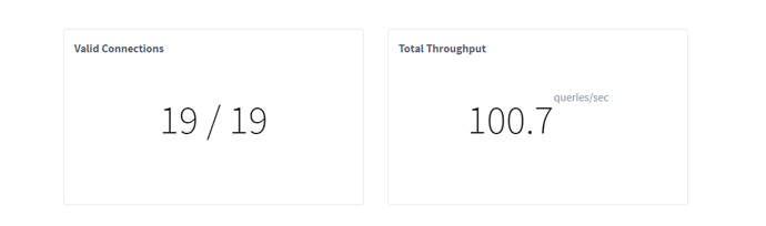

**Overview** :
 ![1](https://us1.discourse-cdn.com/inductiveautomation/original/3X/7/9/798faa357dc3b091929c2fafaa35402996ec61d6.png)

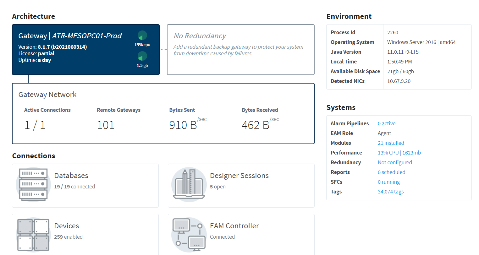

**Performance** :
 ![2](https://us1.discourse-cdn.com/inductiveautomation/original/3X/8/9/897005edadc7e6631380ca60f9c7a641bac5e6a1.png)

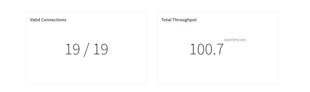

**Database** :
 ![3](https://us1.discourse-cdn.com/inductiveautomation/original/3X/3/1/311395d4dae3fca18fcf0c1d7e558ee314fd4ad4.png)
**Author:** ![bkarabinchak.psi](https://sea1.discourse-cdn.com/inductiveautomation/user_avatar/forum.inductiveautomation.com/bkarabinchak.psi/32/83567_2.png) [@bkarabinchak.psi](https://forum.inductiveautomation.com/u/bkarabinchak.psi)\
**Post date:** [November 4, 2021, 12:31pm UTC](https://forum.inductiveautomation.com/t/ignition-server-delay/52718/2 "2021-11-04T12:31:06Z")
How are you inserting the data into the database? I assume a `system.db.runPrepUpdate` query in your tag change event somewhere. If that is failing, you should see logs in your gateway telling you that the query failed, and whatever database you’re using should send you an error message as to why.
**Post date:** [November 4, 2021, 12:31pm UTC](https://forum.inductiveautomation.com/t/ignition-server-delay/52718/3 "2021-11-04T12:31:23Z")
It’s possible that one or more of your tag event scripts are blocking doing IO or otherwise taking longer than you expect.
When you notice that things are backed up or delayed again try to get a thread dump from the gateway status \> threads page.
**Author:** ![Bogdan](https://avatars.discourse-cdn.com/v4/letter/b/ce7236/32.png) [@Bogdan](https://forum.inductiveautomation.com/u/Bogdan)\
**Post date:** [November 4, 2021, 2:15pm UTC](https://forum.inductiveautomation.com/t/ignition-server-delay/52718/4 "2021-11-04T14:15:01Z")
I’m using system.db.runUpdateQuery(), but we didn’t receive any errors, the data arrived in the DB, but with huge delay, approx. 5 mins
