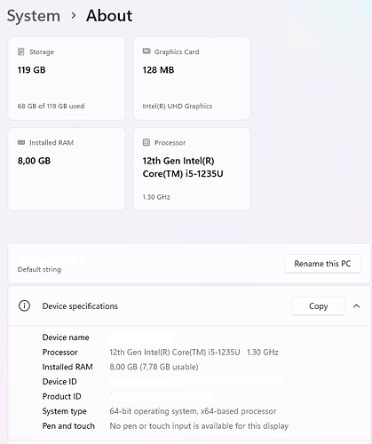

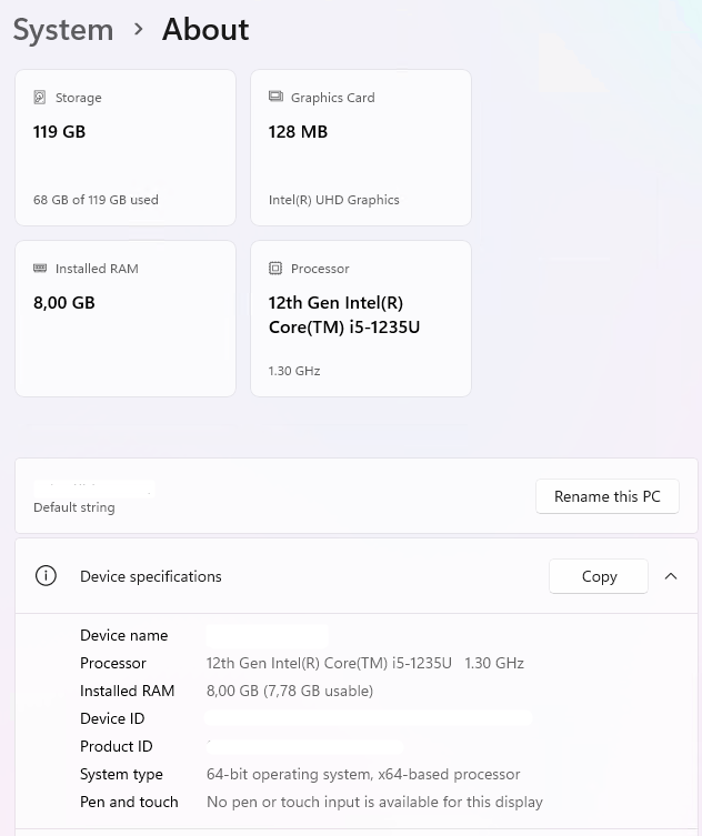

Hi everyone,
We have a PC with the following specifications, and I’d like your advice on whether this setup is suitable for running an Ignition server with one mobile phone and three Perspectiveworkstation clients.
 ![image](https://us1.discourse-cdn.com/inductiveautomation/original/3X/a/f/af0e93b653fbd4a1de3433cddb42bec37e59dc61.png)
Thanks.
**Author:** ![Matrix\_Engineering](https://sea1.discourse-cdn.com/inductiveautomation/user_avatar/forum.inductiveautomation.com/matrix_engineering/32/19781_2.png) [@Matrix\_Engineering](https://forum.inductiveautomation.com/u/Matrix_Engineering)\
**Post date:** [September 16, 2025, 10:17am UTC](https://forum.inductiveautomation.com/t/ignition-server-hardware-requirements/110651/2 "2025-09-16T10:17:51Z")
Should be OK for 4 sessions, but if that grows you would want more RAM to start with.
**Author:** ![TechEnlive](https://avatars.discourse-cdn.com/v4/letter/t/3be4f8/32.png) [@TechEnlive](https://forum.inductiveautomation.com/u/TechEnlive)\
**Post date:** [September 16, 2025, 10:21am UTC](https://forum.inductiveautomation.com/t/ignition-server-hardware-requirements/110651/3 "2025-09-16T10:21:27Z")
Thanks for reply. What are the ideal specifications?
so i can update to client.
