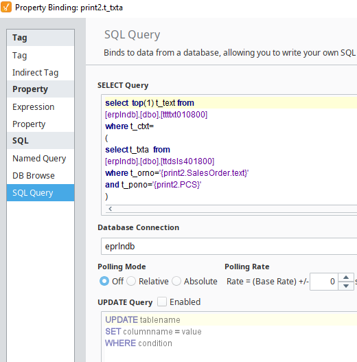

![image](https://us1.discourse-cdn.com/inductiveautomation/original/2X/f/fb32babfa42440d03255475101f94fc29b26d5a5.png)

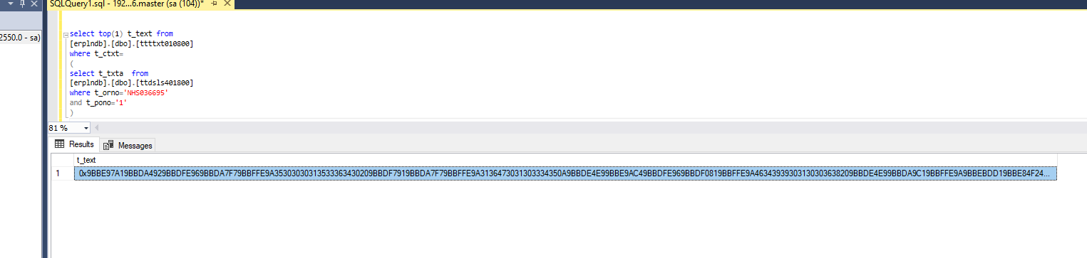

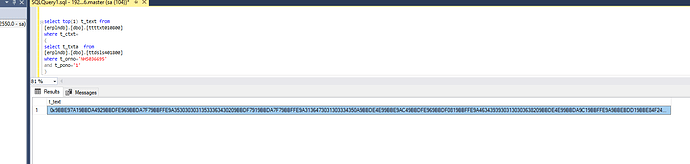

i do the sql query in the server side,
i can see the result is
‘0x9BBE97A19BBDA4929BBDFE969BBDA7F79BBFFE9A35303030313533363430209BBDF7919BBDA7F79BBFFE9A3136473031303334350A9BBDE4E99BBE9AC49BBDFE969BBDF0819BBFFE9A46343939303130303638209BBDE4E99BBDA9C19BBFFE9A9BBEBDD19BBE84F24E549BBDC4F69BBDC4CB9BBDBCA62020200A9BBDF0DB9BBDBDA69BBFFE9A33312E36329BBDF8F320209BBDCAF09BBEA3CF9BBFFE9A319BBDCEE12041544F3A54585A3138383239360A9BBDF7B19BBDB2B49BBDA4B69BBEA0A00A20202020202020202020202020202020202020202020202020202020202020202020202020202020202020202020’
i can use python decode(‘hex’) make it works

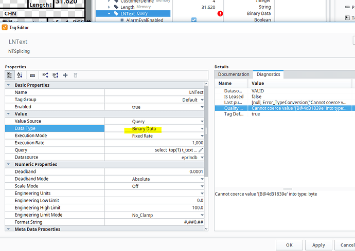

but i found if i use sql tag , the result is not the same

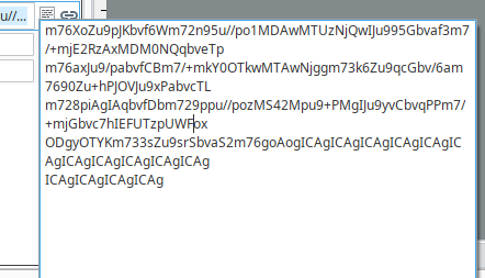

 ![image](https://us1.discourse-cdn.com/inductiveautomation/original/2X/c/c02e9fb77c1f73ba003f54d4c65f9b8f0f178e7f.png) ![image](https://us1.discourse-cdn.com/inductiveautomation/original/2X/3/39570bedac4ba5cffb05f29b7db97be5ad92b18e.png)
why my sql tag is totally different from the result in the sql side?
**Post date:** [May 14, 2020, 3:15pm UTC](https://forum.inductiveautomation.com/t/ignition-sql-tag-result-is-different-from-sql-server-side/34746/2 "2020-05-14T15:15:34Z")
What’s the actual data type of the column you’re returning?
It looks like the JDBC driver or Ignition is automatically coercing it into a different, string-based encoding.

your guess is right, if i set the query tag is string or text , it is what my picture shows
 ![image](https://us1.discourse-cdn.com/inductiveautomation/original/2X/b/bee80cdc4a527090fbfde5a0a359a776fffaa485.png)

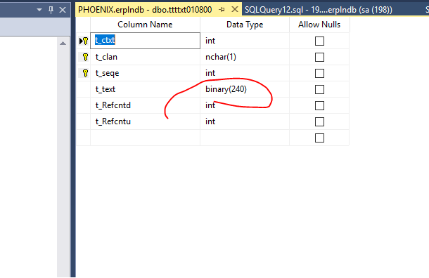

after i check my SQL server side, i found the DataType is binary
 ![image](https://us1.discourse-cdn.com/inductiveautomation/original/2X/2/2da6eb44599386f713cc423c20f1c3ce5e6e50e8.png)
but if i set the tag to Binary Data, it shows connect bad.
how to make the query result the same as what i have done in the sql server side?

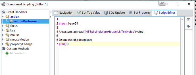

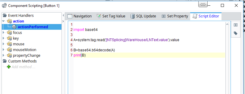

It looks like returning base64 to me. Can you check what you get when you execute the following code on the returned string in Ignition?
```auto
import base64
base64.b64decode(text)
**Author:** ![yifeiliu08](https://avatars.discourse-cdn.com/v4/letter/y/bbe5ce/32.png) [@yifeiliu08](https://forum.inductiveautomation.com/u/yifeiliu08)\
**Post date:** [May 15, 2020, 9:31am UTC](https://forum.inductiveautomation.com/t/ignition-sql-tag-result-is-different-from-sql-server-side/34746/5 "2020-05-15T09:31:19Z")
![image](https://us1.discourse-cdn.com/inductiveautomation/original/2X/8/8ee6f52be0cf52680be66cb652efde305c509a08.png)
it works thanks a lot
