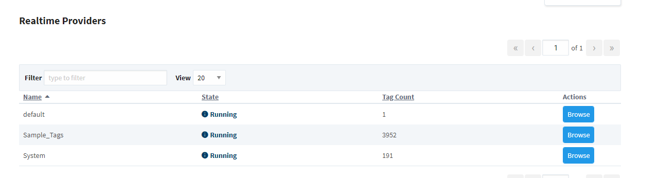

![image](https://us1.discourse-cdn.com/inductiveautomation/original/3X/0/6/06fe272fa623b28150f7f8bd3d7a2fa4d9c862d2.png)
Why is this tag count not updating eventhough I delete some tags?
I don't have these many tags actually.

Are these tags coming from a device or are you using a device simulator? Does disabling and then enabling the provider causes the tag count value to refresh?

They are OPC UA Tags. Deleting the Tag Provider and re-define fixed the problem
