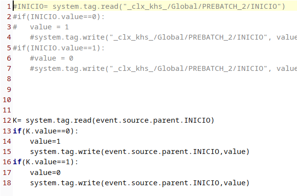

I'm having a problem, I want to make a parameterized template where I can, replicate the same thing, but with different tags, but I have problems when making some scripts on a button within the template
 ![Captura de pantalla 2023-05-12 224644](https://us1.discourse-cdn.com/inductiveautomation/original/3X/4/8/4850d7cf48426cf5e008e4366f516ebf24201555.png)
I want that when I stop releasing the button, it executes the script, which I am taking from the tamplate property and which has a label, but it throws me an error.
 ![Captura de pantalla 2023-05-12 225014_2](https://us1.discourse-cdn.com/inductiveautomation/original/3X/6/7/67adda637c3a0531fec539a457b01764cf3ce66f.png)

It says the issue is on line 12, but you only provided 3 lines. Please provide full code and use the \</\> to format it.

You're taking a script from the template properties ? I somehow doubt that.
**Post date:** [May 13, 2023, 10:48am UTC](https://forum.inductiveautomation.com/t/ignition-template/73677/4 "2023-05-13T10:48:20Z")
We have no idea what line 12 is, but assuming it's the first line one your screenshot, you're trying to read a tag with tag path 'event.source.parent.INICIO' which is invalid.
Python is object oriented. You probably want:
```auto
system.tag.read(event.source.parent.INICIO)
However, this function also returns a QualifiedValue, so you will need to read it's `value` property to compare its value to 1. And, if 1 is actually `True`, then you don't need to compare it to anything, you can just use:
```auto
if K.value:
    Dostuff()

I create a property in the template called INICIO, in the button that is inside the template I want it to take the property of the template and be able to compare.
 ![ignition](https://us1.discourse-cdn.com/inductiveautomation/original/3X/0/3/031c0dd6f0875bdcda4cfa01619e099eba8139ee.png)
I want the template to work with any tag. and can replicate it on multiple screens.
**Post date:** [May 13, 2023, 9:54pm UTC](https://forum.inductiveautomation.com/t/ignition-template/73677/6 "2023-05-13T21:54:57Z")
You're not passing in the value to write the tag to anything, you need to pass this in as the 2nd arg
Both the inline function hints with ctrl+spacebar and the user manual will tell you how to call functions, don't just assume how to call them
