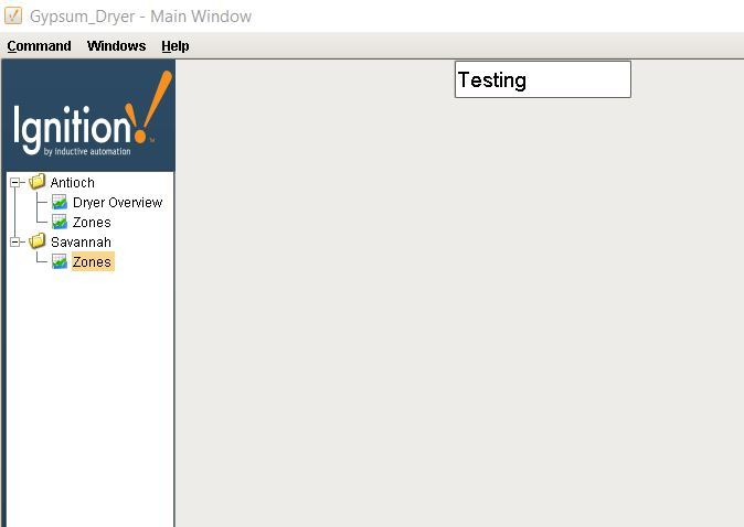

I will post picture here as you can see in tree view Window is having some gap with Navigation tree when viewed in “Client”.
In designer I dont see any gap.
![](https://us1.discourse-cdn.com/inductiveautomation/original/2X/6/67c60d3ab19e5c257f00722c7f8d0428106c825e.JPG)
 ![](https://us1.discourse-cdn.com/inductiveautomation/original/2X/3/35227ea4cf8d43e6c41888eb699acea3d419f615.JPG) ![](https://us1.discourse-cdn.com/inductiveautomation/original/2X/1/1db86486d7d7eee3997cf50d3b21f2464366c396.JPG)
**Author:** ![Paul.Scott](https://sea1.discourse-cdn.com/inductiveautomation/user_avatar/forum.inductiveautomation.com/paul.scott/32/4578_2.png) [@Paul.Scott](https://forum.inductiveautomation.com/u/Paul.Scott)\
**Post date:** [August 7, 2018, 8:11pm UTC](https://forum.inductiveautomation.com/t/ignition-tree-view-navigator-not-aligning-with-window-in-client/19130/2 "2018-08-07T20:11:09Z")
That’s due to [Component Layout](https://docs.inductiveautomation.com/display/DOC79/Working+with+Components#WorkingwithComponents-RelativeLayout). New components in a new project default to a relative-center layout, which is adding the gap.
Right-click on the component and select Layout from the menu. You can change the settings through the resulting popup.
