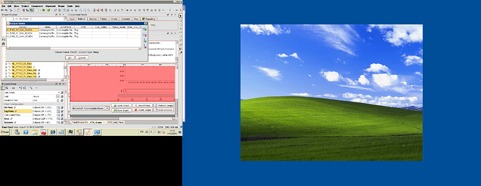

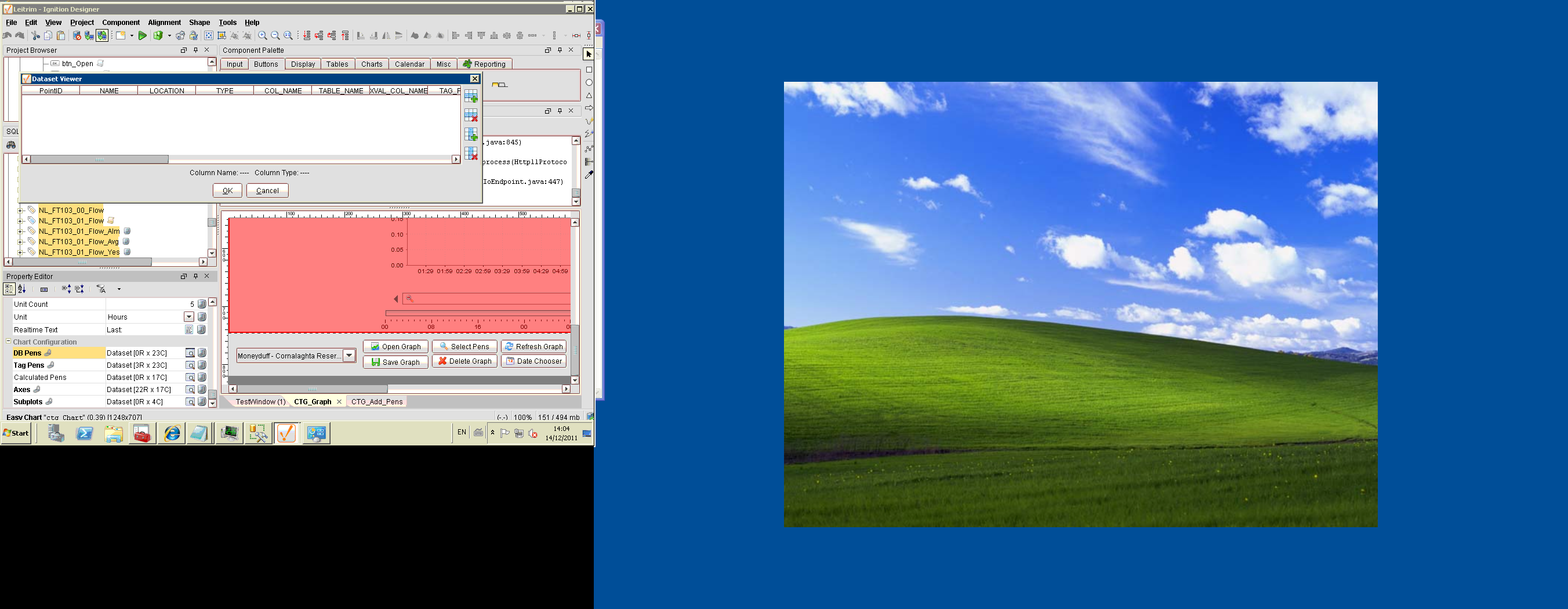

Can you post a screenshot of the tag pens and db pens datasets of the easy chart?
**Author:** ![Dodonnell999](https://avatars.discourse-cdn.com/v4/letter/d/87869e/32.png) [@Dodonnell999](https://forum.inductiveautomation.com/u/Dodonnell999)\
**Post date:** [December 14, 2011, 4:47pm UTC](https://forum.inductiveautomation.com/t/ignition-upgrade-ctg-problems/3742/3 "2011-12-14T16:47:16Z")
I’ve attached screen shots as requested.
I think there’s a bigger problem in that there is no historical data being logged to database.
Could this be caused by me restoring a 7.2.8 backup onto a 7.3.2 ignition?
 ![](https://us1.discourse-cdn.com/inductiveautomation/original/1X/0da97b1353d0dc123f10b5223132609c14b3a399.PNG)
 ![](https://us1.discourse-cdn.com/inductiveautomation/original/1X/95218d6497a460b6d33bd795623e4e31fec442bc.PNG)
