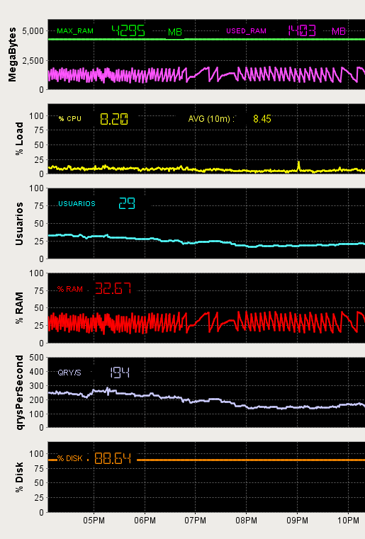

**Author:** ![jruben84](https://avatars.discourse-cdn.com/v4/letter/j/4491bb/32.png) [@jruben84](https://forum.inductiveautomation.com/u/jruben84)\
**Post date:** [February 10, 2017, 10:11pm UTC](https://forum.inductiveautomation.com/t/ignition-uses-a-lot-of-cpu/12407/7 "2017-02-10T22:11:41Z")
Hi,
The Ignition gateway and the database server are in diferent machines. We are currentle running at 200 - 300 qrys/ sec. I attachen a screenshot of the values of our Ignition Server. The graphic has data logger from tags of gateway performance.
As you can see, nowadays is very stable, but in every minute the CPU load goes to 80% - 90% and the exception that I posted before comes out.

Hi I notice that after running for almost a month, the CPU Trend is not changing and remains constant (See the image) What could be the reason?

Hi Steve,
noone Knows what youre are doing in youre Project, you dont give any details.
I can give you some Details on mine:
VritualVM 8 virtual Cores Cisco UCS Cluster with Xeon(R) CPU E5-2630 v3 @ 2.40GHz
~20 Machine Connections Via Opcua
12 Databases Connected sum queries 60/s
17k Tags 2 providers
ca. 20 machines which are communicating via WebDEV Api Calls
> ca. 25 Active Vision Clients
> ca. 20 Active Perspective Sessions
> 4 connected remotegateways
My CPU is very rarely reach 5%.
 ![image](https://us1.discourse-cdn.com/inductiveautomation/original/3X/0/a/0a3e9d39473e2e4ee69c8317ffbeb6d5485a6ba5.png)
So it really depends on youre configuration/programming and connected Clients.
Ignition itself if idle consumes less ressources.
regards,
Roland
