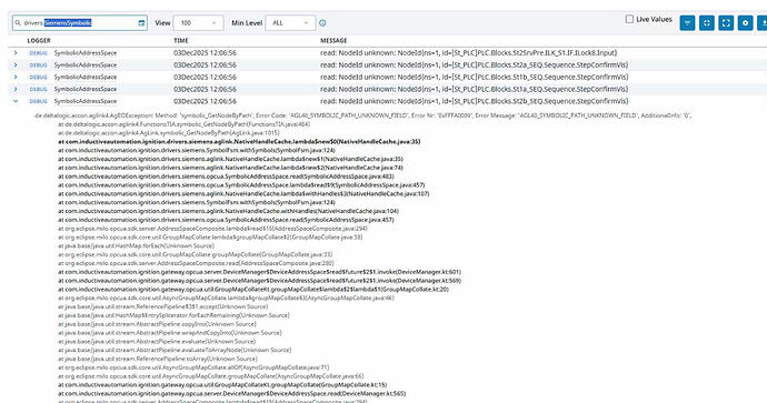

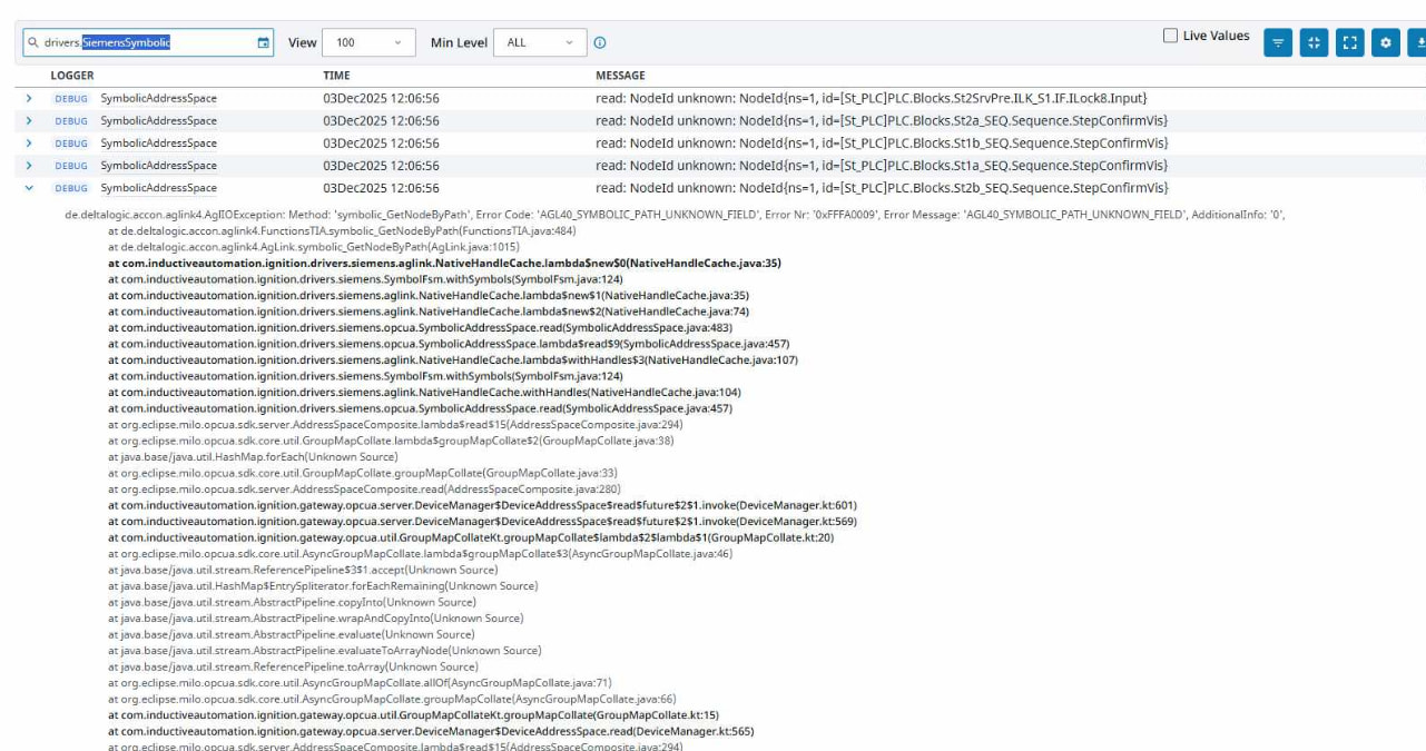

Nah we’re not seeing those errors in the logs i.e. we’re not seeing AGL40\_SYMBOLIC\_NOT\_APPLICABLE, we’re seeing AGL40\_SYMBOLIC\_PATH\_UNKNOWN\_FIELD

> [@nminchin](#):
This usually means the path to the tag on the PLC is wrong. You can see this tag path in the OPC Item Path. This probably shouldn't happen when dragging and dropping from the OPC Browser, unless you have changed the tag structure on the PLC after browsing.

> [@Cody\_Morgan](#):
The path is definitely correct, however I believe this is due to the OPC-UA server still trying to figure out the connection to the PLC. It took in the vacinity of 20-30mins to finally connect and display tags in the opc browser in our dev environment for that single PLC 😬 5mins to load the symbols, then another 15+mins for the tags to finally appear in the opc browser. We only have 2 PLC connections at the moment.

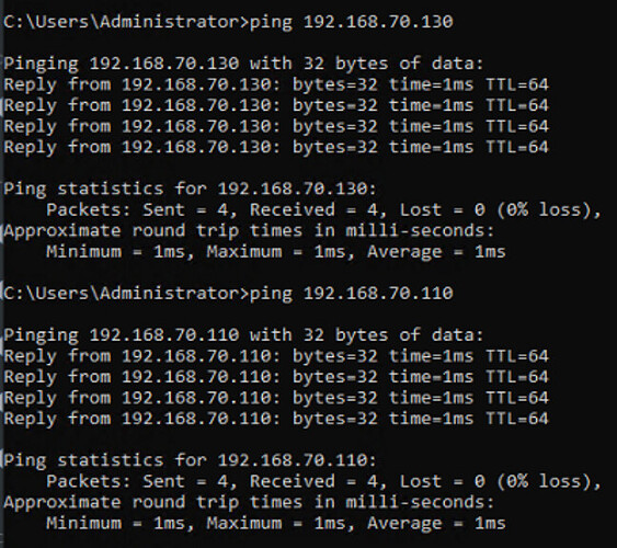

**Author:** ![Cody\_Morgan](https://avatars.discourse-cdn.com/v4/letter/c/db5fbb/32.png) [@Cody\_Morgan](https://forum.inductiveautomation.com/u/Cody_Morgan)\
**Post date:** [December 3, 2025, 5:48am UTC](https://forum.inductiveautomation.com/t/ignition-v8-3-siemens-enhanced-driver-slow-update-rate/111216/12 "2025-12-03T05:48:42Z")
> [@nminchin](#):
> I’m not sure how to check the PLC latency, are you looking for something specific?
I meant network latency between the gateway and PLC. Just ping the PLC from the gateway, you should see roundtrip time in milliseconds. Performance starts to tank as the network latency between the gateway and the PLC increases.
> [@nminchin](#):
Do the `AGL40_SYMBOLIC_PATH_UNKNOWN_FIELD` errors eventually stop repeating? This error comes directly from the AGLink library when we attempt to resolve a node by its path. We shouldn't be attempting to resolve a node by its path until the symbols have completely loaded. If you stop getting those errors, I'm not sure what is going on.

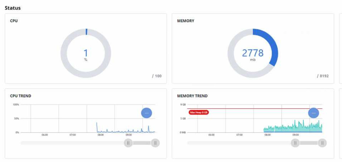

> [@Cody\_Morgan](#):
> As a sanity check, what does the resource usage on your gateway look like?
Resource usage in the web portal for CPU and memory are good

These are the ping response times for both PLCs (1ms response for both):

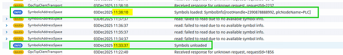

I’m told that there aren’t any more `AGL40_SYMBOLIC_PATH_UNKNOWN_FIELD` logged errors now after connections have come good / tags are reading values, and these opc item paths definitely do exist.

I don't have a good explanation for this. Do you mind sharing your logs via [this Dropbox](https://www.dropbox.com/request/ilZgcCn8hJgcWdrPPEfi) ?
EDIT: I just realized that you were seeing `AGL40_SYMBOLIC_PATH_UNKNOWN_FIELD` _before_ clicking the "Refresh Browse" button. It's totally expected to see this error if you have created the tags on the PLC and on the gateway before clicking "Refresh Browse". (The paths do not exist in the symbol information we have). The expected behavior is that those messages should immediately stop once the symbols have been unloaded. Once the symbols have successfully loaded, then those tags should start working properly.
What I am still unable to explain is all of the slowness. Even if the PLC is slow, I wouldn't expect this to impact the OPC Browser once the symbols have loaded. I'll poke around to see if I can repro, logs _might_ be useful.
