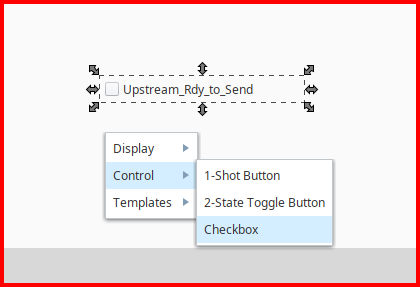

When I drag and drop a **BOOLEAN** tag, I get both the checkbox component and the tag’s name automatically.
However, when I drag and drop a **Numeric Value** tag, I only get the value itself—without the tag name. It seems that only the checkbox component supports both actions (showing the value and the tag name) in one step.
Does anyone know how I can achieve the same behavior for numeric tags?
 ![image](https://us1.discourse-cdn.com/inductiveautomation/original/3X/4/7/474b8f716267cc1b3dfe9b17dde2e249f5bb3d89.png)
 ![image](https://us1.discourse-cdn.com/inductiveautomation/original/3X/b/3/b357bd5f56e6e98304a5bca7474d0e5431464dc8.png)
**Author:** ![michael.flagler](https://sea1.discourse-cdn.com/inductiveautomation/user_avatar/forum.inductiveautomation.com/michael.flagler/32/26272_2.png) [@michael.flagler](https://forum.inductiveautomation.com/u/michael.flagler)\
**Post date:** [August 29, 2025, 10:36pm UTC](https://forum.inductiveautomation.com/t/ignition-vision-drag-and-drop-tags/110287/2 "2025-08-29T22:36:21Z")
You'd have to make your own template that uses a label component with a numeric display component yourself.
