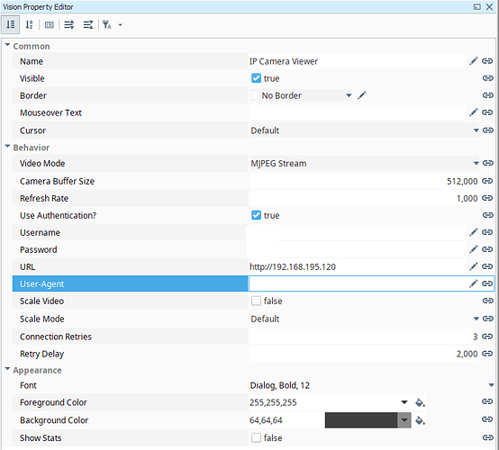

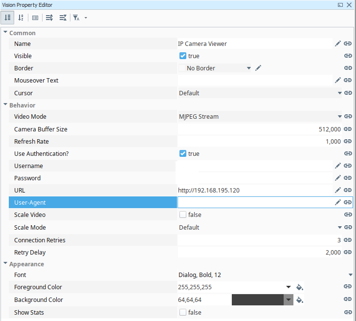

I’m having issues with connecting to an MJPEG stream with the IP Camera Viewer, and I’m at a bit of a loss. The camera is telling me that it’s outputting in MJPEG, and Ignition is giving me an error that the video is not in MJPEG. Any pointers or advice would be greatly appreciated!
I’m running Ignition version 8.1.45
This is in Vision.
I’m attempting to connect to a stream from an Opticom [CC06-NB12VF3-M](https://opticomtech.com/product/cc06-nb12vf3-m/) camera.
What I believe to be the relevant bits from the camera’s configuration:
 ![image](https://us1.discourse-cdn.com/inductiveautomation/original/3X/a/1/a13ac1a308bc93c6936203e26ae87af1b7f907a1.png)
The property window from Vision:
 ![image](https://us1.discourse-cdn.com/inductiveautomation/original/3X/4/5/4569017a8187c54ecddd22ba22830834765633bf.png)

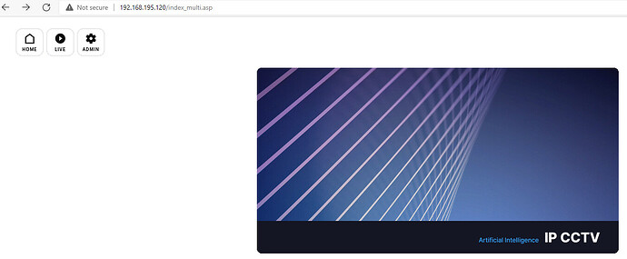

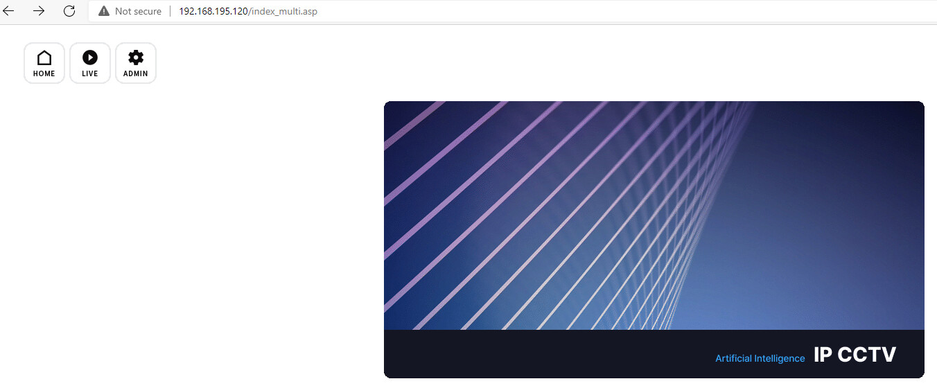

If you open up the url in a web browser, does the video show? Or is it the webpage for the camera with an embedded view of the camera?
**Author:** ![Hugh\_r](https://avatars.discourse-cdn.com/v4/letter/h/eb9ed0/32.png) [@Hugh\_r](https://forum.inductiveautomation.com/u/Hugh_r)\
**Post date:** [August 21, 2025, 2:26pm UTC](https://forum.inductiveautomation.com/t/ignition-vision-ip-camera-viewer-not-recognizing-mjpeg-stream/110043/3 "2025-08-21T14:26:49Z")
That may be the issue. Copying the url over brings me to the camera’s home screen:
 ![image](https://us1.discourse-cdn.com/inductiveautomation/original/3X/8/d/8d1e5f3f81b2ba2a810a9e0e0af50fbf7794e6c3.jpeg)

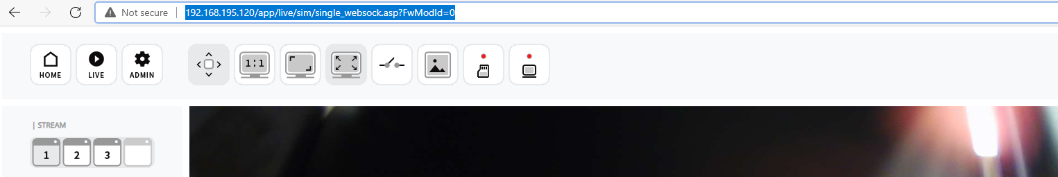

Going to the live view gives a much longer url that gives the same error from Ignition:
 ![image](https://us1.discourse-cdn.com/inductiveautomation/original/3X/0/9/093c0f31d2a5b9c5f8c5dd6b471b2d67c5ddcfdc.png)
Inspecting the page source as ignition’s user manual suggests doesn’t seem to provide any cleaner url to use for the stream.

You will probably need to go back to the manufacturer to get the actual MJPEG link of the stream you want.

In case it helps the next person, the URL that seems to be fully functional for me is:
http://”IP ADDRESS”:”PORT”/cgi-bin/fwstream.cgi?ServerId=0&AppKey=0x00000029&PortId=0&PauseTime=0&FwCgiVer=0x0001
Port is the term used in their documentation. It refers to which of the camera’s streams are being used. The primary stream is port 0.
