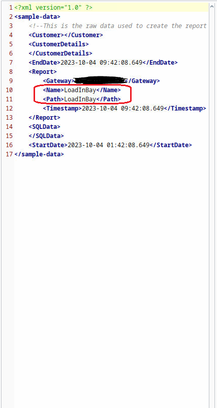

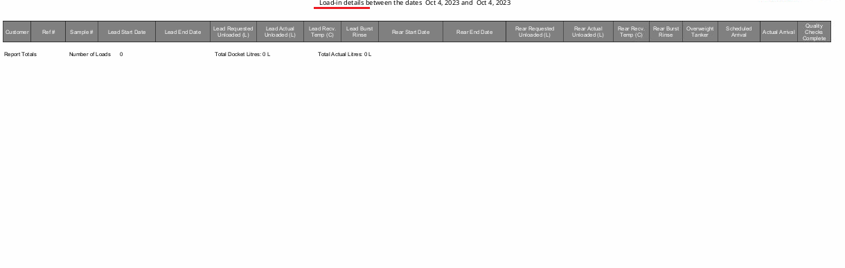

Thanks for the reply. Do you think I should be able to see the row headers in preview mode?
I've got a similar report for another part of this plant (Load In section) which shows the row headers in Preview mode. I've referred both the reports to the same data key. I've attached a few snapshots comparing them. But for some reason the other report, for the Load Out section, doesn't show the row headers in preview mode.
I've gone through both the reports but couldn't figure out what's wrong.
 ![Reports_LoadInPreviewXML](https://us1.discourse-cdn.com/inductiveautomation/original/3X/7/1/711d84cb84ee8b03b79feacdea4b64c36a8ebccc.png)
 ![Reports_LoadInPreview](https://us1.discourse-cdn.com/inductiveautomation/original/3X/1/5/15a96d74d60080f4f930a6c35d1e340710ca39e3.png)
 ![Reports_LoadOutPreviewXML](https://us1.discourse-cdn.com/inductiveautomation/original/3X/f/3/f3c5a6d9848786f96673a2339c2dd7b019094641.png)
 ![Reports_LoadOutPreview](https://us1.discourse-cdn.com/inductiveautomation/original/3X/5/1/5190de732f2e44ea94a56205e3adba262358a68c.png)
**Post date:** [October 3, 2023, 11:05pm UTC](https://forum.inductiveautomation.com/t/ignition-vision-report-viewer-design-and-preview-mode-mismatch/79954/4 "2023-10-03T23:05:24Z")
There's nothing in SQLData. You have no default data to design with. Tables have a bunch of options--it wouldn't surprise me if headers can be hidden when there are no rows.
You _ **really, really** _ should be designing with sample data. Or real data for a default time span. Really.
