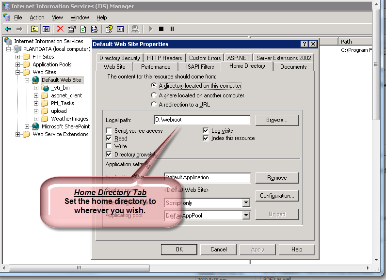

**Post date:** [July 20, 2011, 3:47pm UTC](https://forum.inductiveautomation.com/t/image-management-in-mssql/3113/3 "2011-07-20T15:47:23Z")
In my installation, I have IIS running concurrently with with Ignition’s Apache Server. I save the pictures under IIS and then store the URL into the database. I do this with PDF’s as well.

**Post date:** [July 26, 2011, 9:43am UTC](https://forum.inductiveautomation.com/t/image-management-in-mssql/3113/6 "2011-07-26T09:43:55Z")
OK, here’s what I have set up:
 ![](https://us1.discourse-cdn.com/inductiveautomation/original/1X/371bcaeabb407c9e7ec60a3987e6386fb56da3a1.png)
 ![](https://us1.discourse-cdn.com/inductiveautomation/original/1X/ea7000619cf599ac56222421adba911f748c54b7.png)
 ![](https://us1.discourse-cdn.com/inductiveautomation/original/1X/4f93db6c31be63baec4b2fa424a19bfb5c1e96be.png)
 ![](https://us1.discourse-cdn.com/inductiveautomation/original/1X/7eaef0dc99d32f823c34192d443af67c6955cf58.png)
 ![](https://us1.discourse-cdn.com/inductiveautomation/original/1X/3a513f96966c768a13cc629bed823bfbdbe1d252.png)

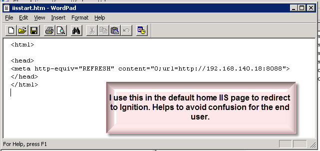

**Post date:** [July 26, 2011, 9:45am UTC](https://forum.inductiveautomation.com/t/image-management-in-mssql/3113/7 "2011-07-26T09:45:14Z")
Bonus tip:
 ![](https://us1.discourse-cdn.com/inductiveautomation/original/1X/1bd8515a074ea2192dce5a803ad26526bda33322.png)
