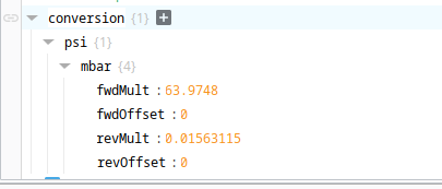

For the next part, my session property would be an object with my outer keys as the first layer, the next layer being my inner keys, and the final layer taking those tuples and enumerating them like “fwdMult,fwdOffset…” Is that right?
Since a picture’s worth 1000 words:
 ![image](https://us1.discourse-cdn.com/inductiveautomation/original/3X/8/b/8b628c7982f7a33df4f2f2e5f2531c8ecc4faefa.png)

The session property would simply be the dictionary holding source units as keys and display units as values. Omit any source unit keys that aren't to be converted.

**Post date:** [January 15, 2026, 3:14pm UTC](https://forum.inductiveautomation.com/t/imperial-metric-conversion-where-do-you-put-your-single-source-of-truth/113313/19 "2026-01-15T15:14:53Z")
Like so?
![image](https://us1.discourse-cdn.com/inductiveautomation/original/3X/0/1/019a32c59842bd7c415dc7700ec5a541c528229f.png)
So for my conversion, I would get the values and do the math in scripting, the session property just tells me what to convert TO if I need to?
