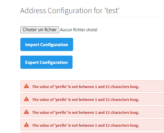

Hi,
I try to import a modbus table from a schneider PLC. When I try to import the file, I get the following message :
The value of 'prefix' is not between 1 and 12 characters long.
![image](https://us1.discourse-cdn.com/inductiveautomation/original/3X/2/6/26e18f9d50e88a88afd7aebe06d99f235910ff1a.png)
Is it possible to get a prefix with more than 12 characters? Why is there any restriction?
Thank you!|
**Author:** ![Matrix\_Engineering](https://sea1.discourse-cdn.com/inductiveautomation/user_avatar/forum.inductiveautomation.com/matrix_engineering/32/19781_2.png) [@Matrix\_Engineering](https://forum.inductiveautomation.com/u/Matrix_Engineering)\
**Post date:** [October 11, 2023, 7:16pm UTC](https://forum.inductiveautomation.com/t/import-address-configuration-get-the-value-of-prefix-is-not-between-1-and-12-characters-long/80356/2 "2023-10-11T19:16:12Z")
The import and export on the modbus mapping pages is meant for Ignition (created) mapping. It does not support importing from 3rd parties.
**Post date:** [October 11, 2023, 7:18pm UTC](https://forum.inductiveautomation.com/t/import-address-configuration-get-the-value-of-prefix-is-not-between-1-and-12-characters-long/80356/3 "2023-10-11T19:18:50Z")
Most recommend to not use the mapping feature at all, instead manually create tags using the following format:
[https://docs.inductiveautomation.com/display/DOC81/Modbus+Addressing](https://docs.inductiveautomation.com/display/DOC81/Modbus+Addressing)
I only use the mapping feature if I have a large amount of consecutive tags.
