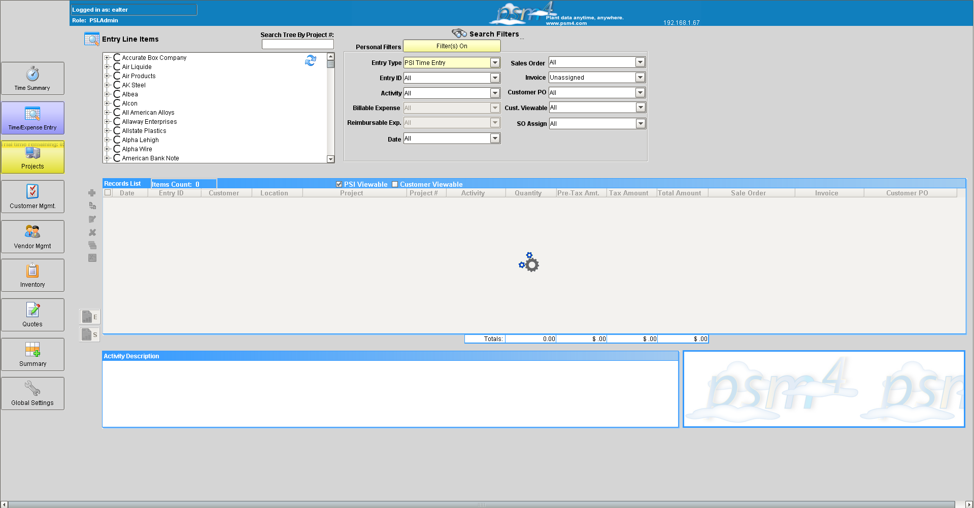

Here’s what it looks like in 7.9.1
 ![image](https://us1.discourse-cdn.com/inductiveautomation/original/2X/c/ce338db65e1d4ab3b9867b234c8a5f8e7e1743be.png)
And here’s what it looks like with 8.0.6
 ![image](https://us1.discourse-cdn.com/inductiveautomation/original/2X/d/d480e31665834e1c407fc2441a691d9906dcdcda.png)
The main thing is the resolution is not the same, I have a left right scroll bar in 8.0 where I didn’t have one in 7.9.1. The project properties regarding resolution are the same and I confirmed the Size properties of the windows are the same. Im not sure how else to fix this?
**Post date:** [January 6, 2020, 3:44pm UTC](https://forum.inductiveautomation.com/t/importing-a-7-9-1-project-to-8-0/31080/4 "2020-01-06T15:44:52Z")
I think the padding of some UI elements along with the font changing could be causing this. You may need to tweak things manually to correct it. The update to the look and feel and new font are not a completely seamless transition unfortunately.

Ok. So the solution would be to go through all my main windows, test height/widths until I get the right size, and then use that size for all my main windows?
**Post date:** [January 6, 2020, 4:02pm UTC](https://forum.inductiveautomation.com/t/importing-a-7-9-1-project-to-8-0/31080/6 "2020-01-06T16:02:56Z")
Hmm, as far as I know, yes, but maybe someone else has found a better solution.
I do think the missing borders on the left buttons are something we’re already tracking or aware of… I need to ask someone who knows more about Vision than I do.
**Author:** ![bkarabinchak.psi](https://sea1.discourse-cdn.com/inductiveautomation/user_avatar/forum.inductiveautomation.com/bkarabinchak.psi/32/83567_2.png) [@bkarabinchak.psi](https://forum.inductiveautomation.com/u/bkarabinchak.psi)\
**Post date:** [January 6, 2020, 4:04pm UTC](https://forum.inductiveautomation.com/t/importing-a-7-9-1-project-to-8-0/31080/7 "2020-01-06T16:04:51Z")
Ok. I’ve been playing with the project property under Launching - Windowed - the width and height which helped up to a point but then stopped doing anything.
**Post date:** [January 6, 2020, 4:34pm UTC](https://forum.inductiveautomation.com/t/importing-a-7-9-1-project-to-8-0/31080/8 "2020-01-06T16:34:23Z")
I was incorrect the project property is not doing anything to help, and changing the size of the height-width on the window is only affecting the canvas size. Not sure what else to try.

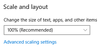

Assuming this is on Windows, what’s your scaling setting configured as?
This setting:
 ![image](https://us1.discourse-cdn.com/inductiveautomation/original/2X/6/68e3d4b9f143fb4fb3833940ed1d7a3f93314b4f.png)
**Post date:** [January 6, 2020, 4:54pm UTC](https://forum.inductiveautomation.com/t/importing-a-7-9-1-project-to-8-0/31080/10 "2020-01-06T16:54:00Z")
Lol wow yup that was it. For Windows 7 Users the default is set to 125% so if you see the same issue this is why. Thanks
