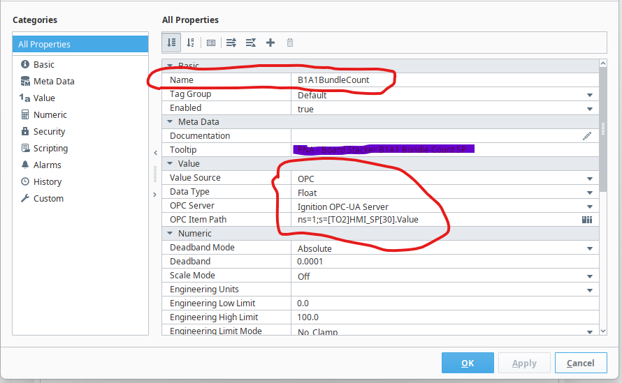

Hey Kevin, I hope things have been going well. I am revisiting this thread again because I have finally got my hands on a small SEL DNP3 device and I am playing around at the moment and just seeing what I can see. I was able to connect the device to ignition using the DNP driver and I was able to import the tags on the device into Ignition. What I found though is the last part of the tag that was effectively the point identifier is dropped off. An example is “DNPMAP\_DNP.AI\_000\_IA” is how the tag is identified inside of the device. In Ignition I see it as “AnalogInput0”. Now for a single device going through and renaming 70 tags isn’t the end of the world, but if this gets scaled up then it could up being a somewhat large time sink. Is there way to make sure that last section that identifies the actual point gets pulled in? Another question, if I change the tag name, so it no long says AnalogInput0 but instead says IA, for the purposes of tag bindings, would the binding be IA or would it still the AnalogInput0, since that is going to be in the opc tag path I think? Sorry for the long post, and thanks for your time.
**Author:** ![MMaynard](https://sea1.discourse-cdn.com/inductiveautomation/user_avatar/forum.inductiveautomation.com/mmaynard/32/3366_2.png) [@MMaynard](https://forum.inductiveautomation.com/u/MMaynard)\
**Post date:** [September 25, 2025, 8:01pm UTC](https://forum.inductiveautomation.com/t/importing-sel-tag-list-into-ignition/100684/7 "2025-09-25T20:01:06Z")
I think you are confusing the Ignition tag NAME and the OPCItemPath.
The tag name can be anything you would like (within the accepted characters of course)
The OPCItemPath is the pointer to the PLC Tag within the PLC itself.
[PLCNameInIgnition]DNPMAP\_DNP.AI\_000\_IA
For example below is a tag NAMED B1A1BundleCount, with an OPCItemPath of ns=1;s=[TO2]HMI\_SP[30].Value
 ![image](https://us1.discourse-cdn.com/inductiveautomation/original/3X/6/4/6432b2c9236fccd78cd1b6e4ab67d61c80215a01.png)
Bindings on controls in Vision or Perspective would be pointed at the B1A1BundleCount tag using the full path to it in the Ignition tag tree.
Hint\* You can right click the tag and choose Copy Path, then paste it to a text editor to see the full path to the tag including the provider name.
