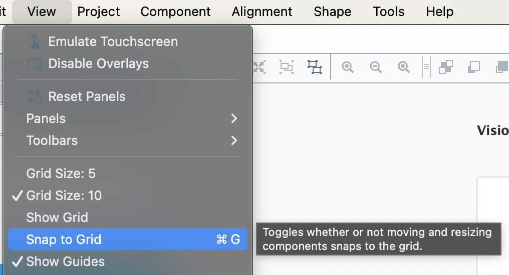

Hello. By default, when moving an object around in Vision in the Ignition Designer, the arrow keys will increment/decrement the x or y position of the selected object by 1px.
At some point while development, I believe I hit some unknown keyboard shortcut. Now using my arrow keys will immediately snap the selected object to the nearest x y pixel coordinate that is a multiple of 10, and increment/decrement the x/y position coordinate by 10px for each press. I find this extremely annoying and would like to revert back to the default behavior. Can anyone tell me how to do this?
**Post date:** [July 15, 2024, 2:56pm UTC](https://forum.inductiveautomation.com/t/imprecise-arrow-keys/93231/2 "2024-07-15T14:56:45Z")
View -\> Snap to Grid:
 ![image](https://us1.discourse-cdn.com/inductiveautomation/original/3X/3/d/3d921e3ac79aeee0719e8c6def0fa55611238fbb.jpeg)
The shortcut is Ctrl + G, which is what you probably hit by accident.
