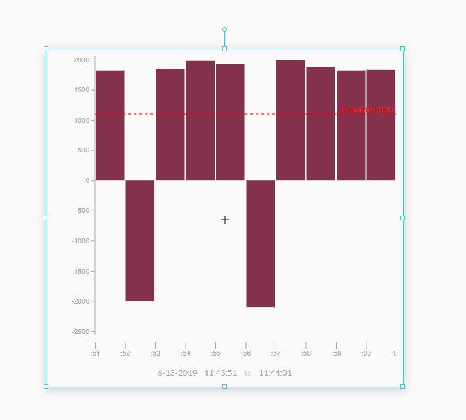

Basically i have tried to make a baseline at 1820 and start bars from there and also tried to change the position of x axis but i was unsuccessfull at that,if anyone understands my issue please respond whether its possible or not if yes how can we make bars start at a specfic pint like y = 1820 or change the position of x axis
 ![Screenshot 2025-10-27 121456](https://us1.discourse-cdn.com/inductiveautomation/original/3X/e/c/ecdc4695bfa08c38b1b2b89022cada9f24415efd.png)

I'm not at my laptop, but I think this is under `props.yAxes[x].range`

And make sure you got ‘useStrict’ enabled.
