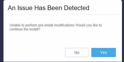

Dear all,
we have problem upgrading our Ignition 7.9 to 8.1. This is a test VM to see if all the projects survive the upgrade, hence it is not licensed. Anyway, while upgrade is running, the 2-hour trial takes place. I have tried ordinary tools from my toolbelt (e.g. running installer as an administrator, give proper permissions to folder where Ignition is installed (r/w for everyone during the installation)), yet I don't have any luck.
 ![1](https://us1.discourse-cdn.com/inductiveautomation/original/3X/7/a/7a7bc4956334c4475ec39bbd639dd82703fbd10d.png)
 ![2](https://us1.discourse-cdn.com/inductiveautomation/original/3X/2/0/20ef032db7ce26ebd628fc29f298e8c87bff15cb.png)
 ![3](https://us1.discourse-cdn.com/inductiveautomation/original/3X/5/5/55c1ef75d0e831f06e2cf12649047fa75745c311.png)
The problems manifest themselves with what the screenshots show.
[install\_20230622-1600.log](https://forum.inductiveautomation.com/uploads/short-url/ogqeHaa7Z9ucbkx8bUYRGqA2vln.log) (13.8 KB)
Log from the installer is also attached. I have read through the log, but I am not finding anything moving me forward. Thank you in advance.

> java.nio.file.FileSystemException: C:\Program Files\Inductive Automation\Ignition\lib\catapult.jar -\> C:\Users\adm.xyz\AppData\Local\Temp\11\_ignition\_preinstall\_temp12179683200774121723\lib\catapult.jar: The process cannot access the file because it is being used by another process.
Overzealous security software, perhaps? A random .jar file in a temp directory should absolutely not be 'in use' by anything besides Ignition itself. Talk to your IT department.

I ran into the same issue when upgrading from 7.9 to 8.1.
I ended up just taking a backup, uninstalling 7.9, installing 8.1 and restoring the backup.
The only "security" software on this host is "CrowdStrike Falcon Sensor". Maybe you have that or a similar piece of software installed.

Hello all, the main reason was that the administrator installing the 8.1 had Gateway launcher utility running as I have learned afterwards. Hence the installer could not touch this file. Terminating the process of gateway utility has solved the problem. I hope this helps to others having similar problems.
