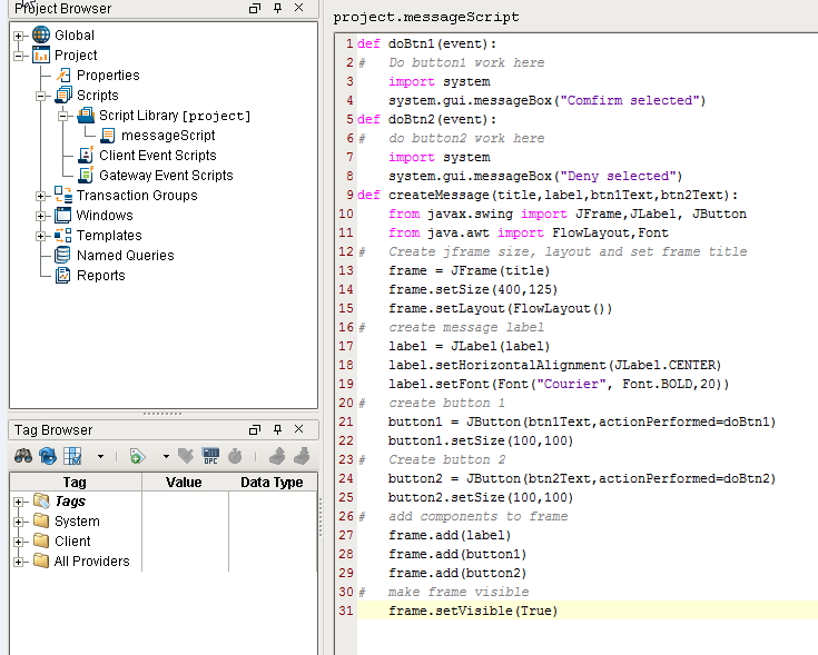

**Post date:** [December 11, 2018, 2:34pm UTC](https://forum.inductiveautomation.com/t/increase-size-of-the-messagebox/21240/11 "2018-12-11T14:34:26Z")
To make the custom jframe message reusable, apply the following to a project script:
> **Project Level Script**
> ```auto
> def doBtn1(event):
> import system
> system.gui.messageBox("Confirm selected")
> def doBtn2(event):
> import system
> system.gui.messageBox("Deny selected")
> def createMessage(title,label,btn1Text,btn2Text):
> from javax.swing import JFrame,JLabel, JButton
> from java.awt import FlowLayout,Font
> frame = JFrame(title)
> frame.setSize(400,125)
> frame.setLayout(FlowLayout())
> label = JLabel(label)
> label.setHorizontalAlignment(JLabel.CENTER)
> label.setFont(Font("Courier", Font.BOLD,20))
> button1 = JButton(btn1Text,actionPerformed=doBtn1)
> button1.setSize(100,100)
> button2 = JButton(btn2Text,actionPerformed=doBtn2)
> button2.setSize(100,100)
> frame.add(label)
> frame.add(button1)
> frame.add(button2)
> frame.setVisible(True)
example:
 ![](https://us1.discourse-cdn.com/inductiveautomation/original/2X/9/9c7685e7730e059197fbaa66ffb86fa0abe23efc.PNG)
Then where ever you want to call the message box, add the following code.
> **Component Level Script**
> ```auto
> title = "Message"
> label = "Hell World in a custom JFrame"
> btn1Text = "Confirm"
> btn2Text = "Deny"
> project.messageScript.createMessage(title,label,btn1Text,btn2Text)
Setting up the frame title, label, and button labels allows you to dynamically create the message box you need in different situations. You can also add the message box size parameters into the method call and methods created in the project level script to make its size dynamic dependent on what kind of device you are using.
Hope this helps.
