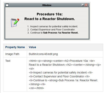

Thanks, I was also able to find this in Ignition. Great for bolding and size (h) height I suppose.
 ![image](https://us1.discourse-cdn.com/inductiveautomation/original/3X/8/9/89b8cb348ebf7d07fb172ac2696488cf5e86e55c.jpeg)
**Post date:** [March 30, 2022, 7:17pm UTC](https://forum.inductiveautomation.com/t/increasing-font-in-a-message-box-with-html/57827/4 "2022-03-30T19:17:01Z")
> [@christopher.raphael](#):
The `<h*>` tags are known as heading tags. There are 6 different sizes where `<h1>` would be the heading with most significance and `<h6>` would be the heading with least significance.
You can also use `<b>` tags for bolding text.
