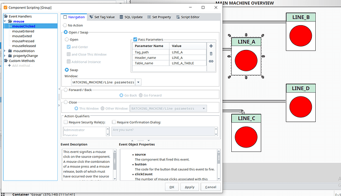

I know template repeaters and UDTs are very useful for creating multi-instance objects or screens and tags.
Yes, all line tag path is the same like a `[Sample_Tags]Batching_machine/Line_A/Inlet_valve' `is the same as for other lines, only line name changes like` ``[Sample_Tags]Batching_machine/Line_B/Inlet_valve'`.
I create a line-wise object in the main overview and add a screen swap function to move to another screen. All line-wise items are passed parameters such as tagpath, screen header name, and table name.
When I click on the object, it goes to the specific line graphics and displays the parameter of the line.
main overview
 ![image](https://us1.discourse-cdn.com/inductiveautomation/original/3X/d/9/d9be3c081290d3d120a63905020c59b7c5904ec1.png)
Pass the parameter in line wise object.
 ![image](https://us1.discourse-cdn.com/inductiveautomation/original/3X/f/2/f2050e3870b8fcbca81968e2d28c1fd63b04f156.png)
Created a master screen for the line and added custom properties such as tagpath, screen header name, and table name. This custom property is reflected in the data when selecting a specific line object from the main overview.
Add a custom property in the Main master line graphics.
 ![image](https://us1.discourse-cdn.com/inductiveautomation/original/3X/4/0/4096ef07f6e639096b57fbd2039f8cb666f0f4c3.png)
Defined the all object tag path and Screen\_header name using indirect tag binding.
 ![image](https://us1.discourse-cdn.com/inductiveautomation/original/3X/a/5/a5cc6943ed5ba697534ea5002a377d723a0d7719.png)
My question is how to defined in the trends as per above function using?
