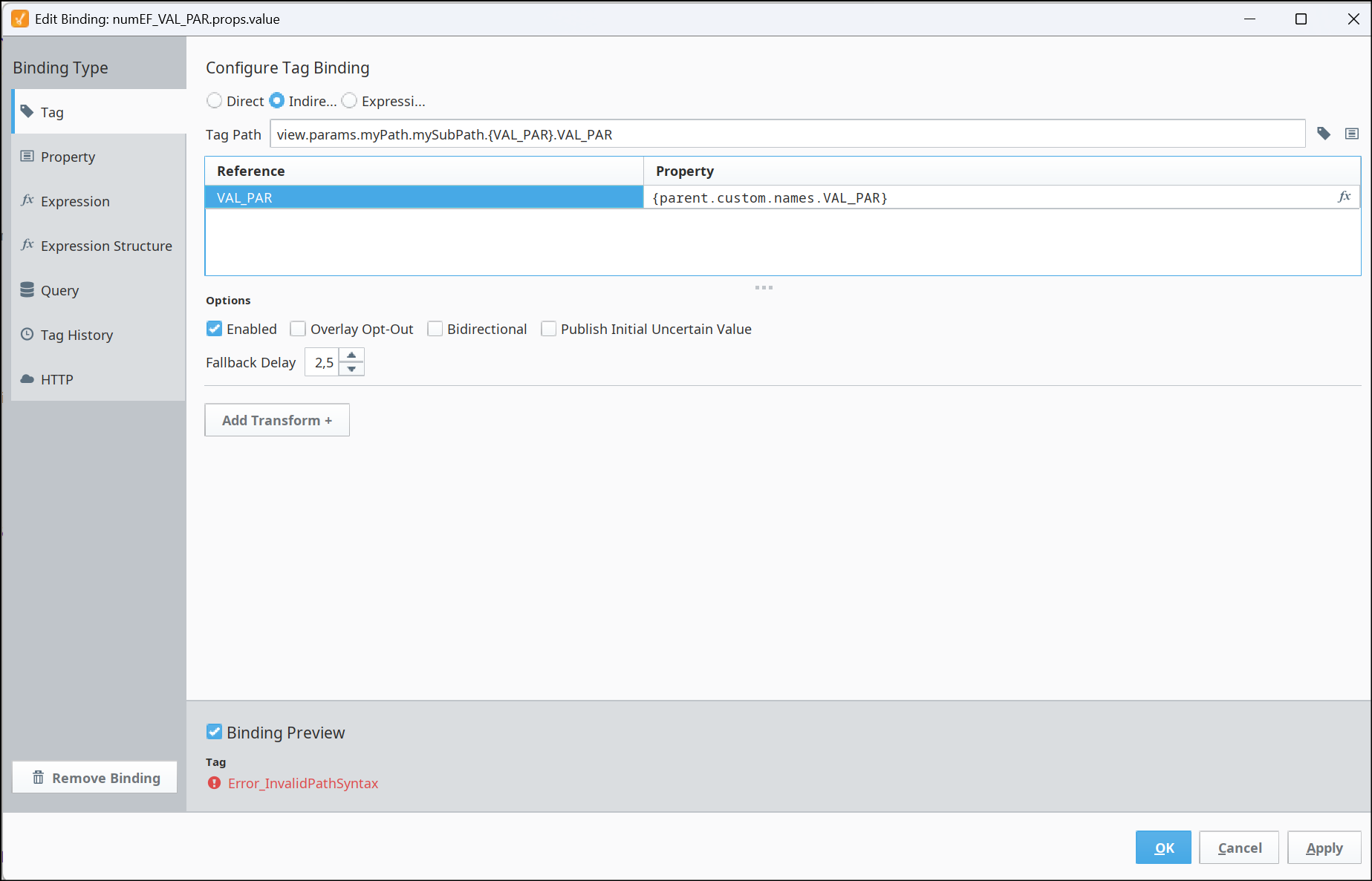

Good morning,
I’m trying to create an indirect binding but I’m not able.
I have a parameter path and a custom property in a flex repeater. I want to access to the parameter dynamically using this kind of binding:
 ![image](https://us1.discourse-cdn.com/inductiveautomation/original/3X/3/7/37495ce7b4eafb28a381ec7183839cbf0a0b2eaf.png)
I’m pretty sure I’m doing something wrong, I’ve used indirect binding on UDT or tags, but never with parameters.
How should I change it?
**Author:** ![Aiasa21](https://avatars.discourse-cdn.com/v4/letter/a/aeb1de/32.png) [@Aiasa21](https://forum.inductiveautomation.com/u/Aiasa21)\
**Post date:** [December 9, 2025, 9:23am UTC](https://forum.inductiveautomation.com/t/indirect-binding-on-parameter-not-working/112694/2 "2025-12-09T09:23:53Z")
I continue searching in the forum and finally I make it works using `property()` in a normal expression binding instead of using an Indirect Tag Binding.
