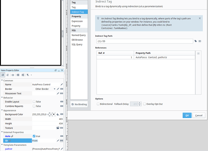

More of a nuisance, but if there's a simple solution, I'd like to know, or if I'm doing something wrong:
I have a template with a sparkline that resolves to an indirect partial path passed to the template custom property. I do have a default value typed into this custom property. Within the template, this property is an indirect within the sparkline to the historical tag path.
On client startup, and likely when this window with the templates is opened, i get a database entry error in the gateway logs, and the path part that uses the custom property is Null. So somehow the sparkline is querying the historian with an unformed path. Then, of course after that, no more errors, as presumably the property resolves to the binding and all is well.
Its not causing any issues other than irrelevant entries in the logger. But is there a better way to avoid this?

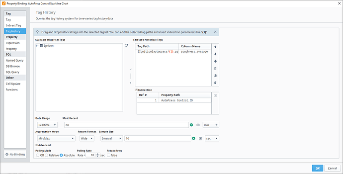

Show your history binding and the template's parameter setup.
**Post date:** [September 9, 2025, 2:33pm UTC](https://forum.inductiveautomation.com/t/indirect-bindings-resolve-order-in-regards-to-templates-and-historian/108391/7 "2025-09-09T14:33:52Z")
This is the current iteration where I moved the “ID” to an internal template parameter bound to a memory Tag within the passed pathstr folder. Before, I was passing the ID as an additional template parameter and that didn’t change the behavior. The Error in the logger only occurs on first load of the window/Project. Afterwards, its fine until the Project is restarted. The tag path in the error shows “\_press” instead of “front\_press”.

Hmmm. May not be fixable. Try with polling off, and cause it to refresh separately (with `system.db.refresh()`).
**Post date:** [September 9, 2025, 3:54pm UTC](https://forum.inductiveautomation.com/t/indirect-bindings-resolve-order-in-regards-to-templates-and-historian/108391/9 "2025-09-09T15:54:22Z")
I was trying to think of a way to “delay” initial sparkline polling. Is it possible to do as you suggest, turning off polling, then programmatically re-enable polling after X time? Or is that more hokey than just using a repeat timer on the template and doing a refresh?
**Post date:** [September 9, 2025, 4:02pm UTC](https://forum.inductiveautomation.com/t/indirect-bindings-resolve-order-in-regards-to-templates-and-historian/108391/10 "2025-09-09T16:02:02Z")
An option would be to move the history binding to a custom prop, and disable the overlay for that binding. Then use a change script to move good results to the spark line's data property.
**Post date:** [September 9, 2025, 4:30pm UTC](https://forum.inductiveautomation.com/t/indirect-bindings-resolve-order-in-regards-to-templates-and-historian/108391/11 "2025-09-09T16:30:17Z")
Ok, will try that. Reading the docs, polling off still refreshes one time on initial load, so I think I'd have the same issue with unformed tag path error.
