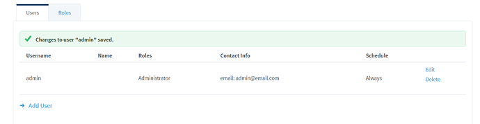

Right, that’s what I am doing but what I’m saying is that it appears that `email` is not included in the returned user info from the system function
 ![image](https://us1.discourse-cdn.com/inductiveautomation/original/3X/5/0/508d017904cd5a621b857a3c6ec123e1dfb14167.png)
![image](https://us1.discourse-cdn.com/inductiveautomation/optimized/3X/9/6/96a12862ca7db09d345890ca44311532a8757095_2_689x45.png)
Using your code, it does seem to successfully get the contact info but the `contactInfo` attribute seems to come out of nowhere. Why isn’t it displayed in the list?

It’s a [User object](https://www.docs.inductiveautomation.com/docs/8.1/appendix/reference-pages/scripting-object-reference#users), for whatever reason the contact info isn’t included in the repr method.
**Post date:** [October 8, 2025, 2:01pm UTC](https://forum.inductiveautomation.com/t/information-required-for-alarm-pipeline/111252/8 "2025-10-08T14:01:01Z")
Contact Info is a nested list in the user object.
**Author:** ![amarks](https://sea1.discourse-cdn.com/inductiveautomation/user_avatar/forum.inductiveautomation.com/amarks/32/45610_2.png) [@amarks](https://forum.inductiveautomation.com/u/amarks)\
**Post date:** [October 8, 2025, 2:12pm UTC](https://forum.inductiveautomation.com/t/information-required-for-alarm-pipeline/111252/9 "2025-10-08T14:12:19Z")
Would be nice if the documentation listed all attributes of the user object
**Post date:** [October 8, 2025, 2:15pm UTC](https://forum.inductiveautomation.com/t/information-required-for-alarm-pipeline/111252/10 "2025-10-08T14:15:31Z")
The `getContactInfo()` method is documented. 🤷‍♂️
Or perhaps you are confused by jython's automatic conversion of NetBeans-style getter methods into implicit properties? (Which is why `.contactInfo` works.)
