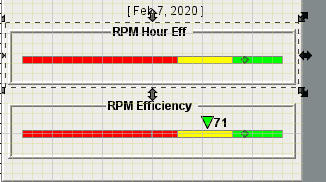

![Moving%20Analog%20Indicator](https://us1.discourse-cdn.com/inductiveautomation/original/2X/0/04fc6e20d73d4cfa2a3c6a6ba19d0bad5b50f39a.png)
The top indicator is missing because the Process Value is 114% on a scale of 100
Is there a way to make the indicator stay on the bar without affecting the historized value of the tag and maybe indicate the value is off scale?
**Author:** ![jpark](https://avatars.discourse-cdn.com/v4/letter/j/a88e57/32.png) [@jpark](https://forum.inductiveautomation.com/u/jpark)\
**Post date:** [February 8, 2020, 2:00am UTC](https://forum.inductiveautomation.com/t/ingition-designer-7-9-moving-analog-indicator-and-indictor-range-clamp/32065/2 "2020-02-08T02:00:31Z")
Sure. Put a custom property that is bound to the tag. Then put an expression on the indicator value along the lines of if tagvalue is greater than 100 then 100 else tagvalue
**Author:** ![jlandwerlen](https://avatars.discourse-cdn.com/v4/letter/j/bc8723/32.png) [@jlandwerlen](https://forum.inductiveautomation.com/u/jlandwerlen)\
**Post date:** [February 8, 2020, 2:46am UTC](https://forum.inductiveautomation.com/t/ingition-designer-7-9-moving-analog-indicator-and-indictor-range-clamp/32065/3 "2020-02-08T02:46:38Z")
Clamp and/or scale in the PLC.
