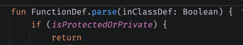

**Post date:** [March 20, 2026, 8:22pm UTC](https://forum.inductiveautomation.com/t/inheritable-script-docstrings-in-project-library-not-populating-intellisense-popup/114605/6 "2026-03-20T20:22:15Z")
It's the underscore.
 ![image](https://us1.discourse-cdn.com/inductiveautomation/original/3X/4/d/4dae577dfbfdab4e32efaed2c01a74bcc39680a2.png)
 ![image](https://us1.discourse-cdn.com/inductiveautomation/original/3X/f/e/fe646829afd881ee8b832e0280f17c59d4e0de57.png)

**Post date:** [March 20, 2026, 8:27pm UTC](https://forum.inductiveautomation.com/t/inheritable-script-docstrings-in-project-library-not-populating-intellisense-popup/114605/8 "2026-03-20T20:27:08Z")
The actual function names.
The logic is that leading underscores 'by convention' mean something that should only be usable within the same script, so no point hinting them in other contexts even if they're technically callable.
The system will prevent you from naming your project library anything with conflicts that'll cause you issues with imports; beyond that I'd avoid anything like `list` or `str` or other builtin functions.
**Author:** ![Philip\_Knowlton](https://avatars.discourse-cdn.com/v4/letter/p/e495f1/32.png) [@Philip\_Knowlton](https://forum.inductiveautomation.com/u/Philip_Knowlton)\
**Post date:** [March 20, 2026, 8:37pm UTC](https://forum.inductiveautomation.com/t/inheritable-script-docstrings-in-project-library-not-populating-intellisense-popup/114605/9 "2026-03-20T20:37:15Z")
Thanks @paul-griffith !
I had to delete the script entirely and add it back in before it would re-parse correctly, but now it’s populating! I love this community so much, you guys are rockstars.
