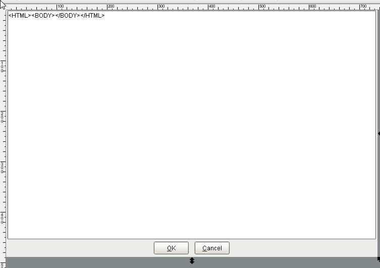

I am developing context based help pages for a ‘canned’ application we have using Ignition.
I am creating help pages such as this with HTML:
 ![](https://us1.discourse-cdn.com/inductiveautomation/original/2X/8/8fe0460449dbd72f4ed4ded8d41da3a85939a8c5.jpg)
I would like to take screen shots and store a \*.jpg and wrap text around the images to create rich help pages. I cannot find the path to the gateway image folder :
 ![](https://us1.discourse-cdn.com/inductiveautomation/original/2X/3/3cdb9ef258113d5d80f0e7441649da0d8f69a721.jpg)
Is this possible , and can I add images into the HTML text?

Sure, the images get “mounted” at [tt][http://your-gateway](http://your-gateway):port/main/system/images/[/tt]
So for example:
[tt][http://your-gateway](http://your-gateway):port/main/system/images/document\_edit.png[/tt]
