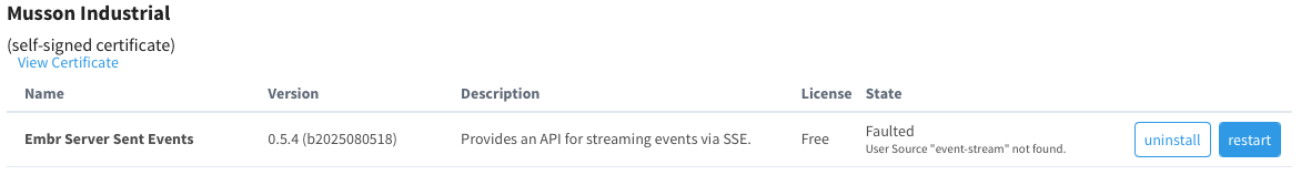

Are you trying to consume SSE or produce SSE data?
If you’re producing SSE data, I’ve got a module that does that.

Ha, you might want to find a name other than "EventStream" / "event-stream" or things are going to get confusing quick once 8.3 is out.
**Author:** ![bmusson](https://sea1.discourse-cdn.com/inductiveautomation/user_avatar/forum.inductiveautomation.com/bmusson/32/87530_2.png) [@bmusson](https://forum.inductiveautomation.com/u/bmusson)\
**Post date:** [February 19, 2025, 2:25pm UTC](https://forum.inductiveautomation.com/t/integration-sse-events-server-sent-event-with-ignition-perspective-applications/102528/6 "2025-02-19T14:25:58Z")
Yes I know 🤦‍♂️
Case of bad timing, I released the first version like a month before y’all announced your Event Streams feature.
It’ll probably get named Embr-SSE. Also, I’m interested in trying to make an SSE source/connector for Event Streams, which I think is exactly the feature this OP is looking for.

Hi @bmusson ,
i have installed the module, but got an error
 ![Screenshot 2025-08-09 at 16.54.43](https://us1.discourse-cdn.com/inductiveautomation/original/3X/f/6/f6bd0fc873e17e2f7b23dee6c742dc6e3480aa48.png)
Do you have any documentation on how to use it?
Regards
**Post date:** [August 9, 2025, 3:18pm UTC](https://forum.inductiveautomation.com/t/integration-sse-events-server-sent-event-with-ignition-perspective-applications/102528/16 "2025-08-09T15:18:48Z")
The module is the most neglected out of all the Embr modules.
If you manually create a user source named “event-stream”, that error should go away and the module should behave as the GitHub README describes.
What’s your use case?
