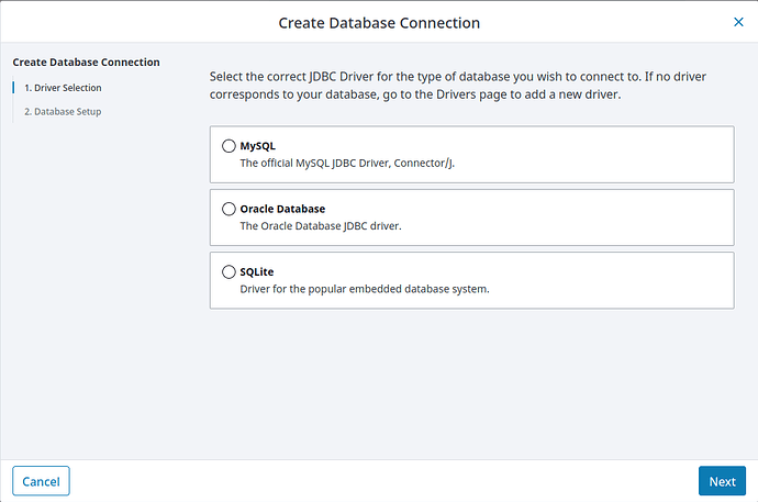

**Author:** ![David\_Folkner](https://avatars.discourse-cdn.com/v4/letter/d/bb73d2/32.png) [@David\_Folkner](https://forum.inductiveautomation.com/u/David_Folkner)\
**Post date:** [August 5, 2025, 1:22pm UTC](https://forum.inductiveautomation.com/t/internal-historian-questdb-not-listed-in-database-query-browser/109238/15 "2025-08-05T13:22:44Z")
![image](https://us1.discourse-cdn.com/inductiveautomation/original/3X/5/b/5b027b72874330cfa8bde5c2ff2b2653d652f93d.png)
There is no choice for PostGres out of the box, I'd need to upload my own JDBC drivers I think.
And though read only is great, some customers want even read access to be limited...
**Author:** ![Kyle.Chase](https://avatars.discourse-cdn.com/v4/letter/k/3bc359/32.png) [@Kyle.Chase](https://forum.inductiveautomation.com/u/Kyle.Chase)\
**Post date:** [August 5, 2025, 1:50pm UTC](https://forum.inductiveautomation.com/t/internal-historian-questdb-not-listed-in-database-query-browser/109238/16 "2025-08-05T13:50:36Z")
Is this a fresh install or an upgrade? We provide a Postgres JDBC Module, which should be present on a fresh install.
**Post date:** [August 5, 2025, 2:29pm UTC](https://forum.inductiveautomation.com/t/internal-historian-questdb-not-listed-in-database-query-browser/109238/19 "2025-08-05T14:29:11Z")
> [@THauptman](#):
> Thanks in advance for your help!
Fresh install using docker.
**Author:** ![michael.flagler](https://sea1.discourse-cdn.com/inductiveautomation/user_avatar/forum.inductiveautomation.com/michael.flagler/32/26272_2.png) [@michael.flagler](https://forum.inductiveautomation.com/u/michael.flagler)\
**Post date:** [August 5, 2025, 2:52pm UTC](https://forum.inductiveautomation.com/t/internal-historian-questdb-not-listed-in-database-query-browser/109238/20 "2025-08-05T14:52:54Z")
You have to modify the `ignition.conf` file to enable PGwire and restart the gateway to enable the database connection.
