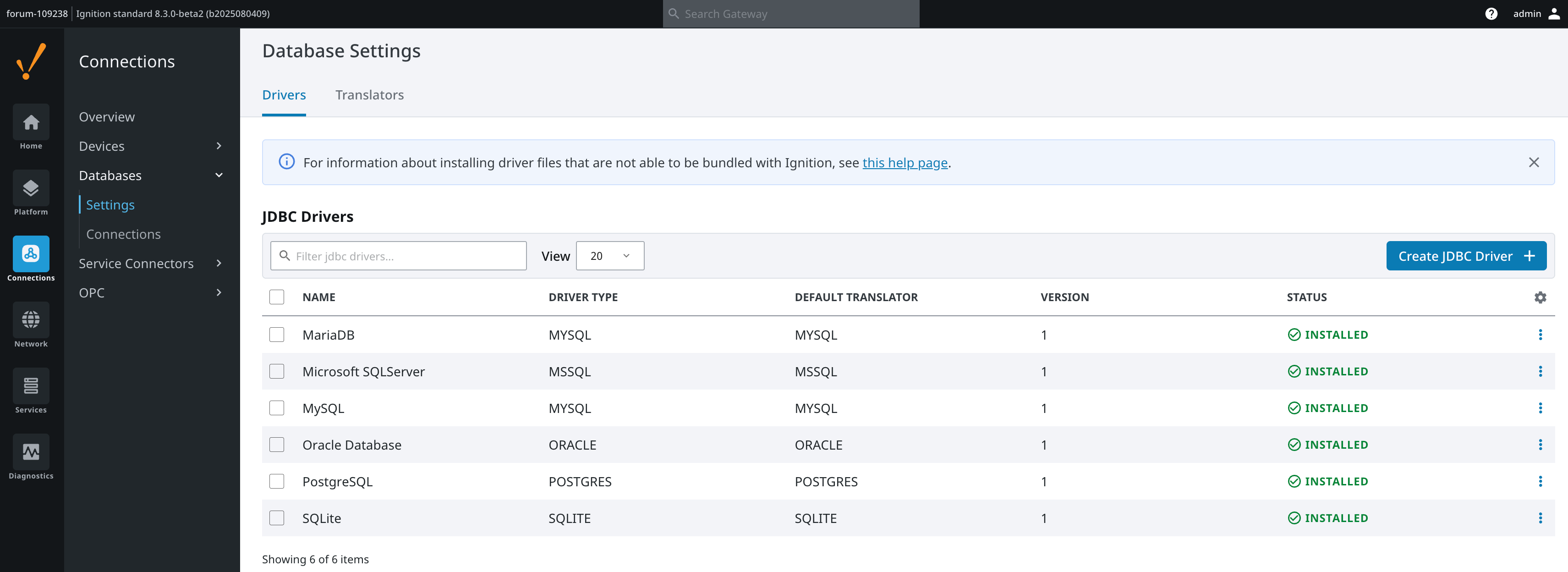

Can you show the database drivers listed under `/app/connections/databases/settings/drivers-jdbc` ?
 ![SCR-20250805-lrrn](https://us1.discourse-cdn.com/inductiveautomation/original/3X/1/d/1d324c079c0fffae374a20ff700d7882426e9d0b.png)
EDIT: whoops, I didn't see your follow-up reply.. Please disregard. Glad you got it working! 🎉
