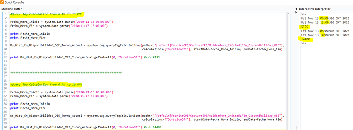

Good afternoon.
In Ignition **8.0.14** , I have configured a tag to **history** with this Tag Group (Scan Class):
![image](https://us1.discourse-cdn.com/inductiveautomation/original/3X/7/4/7430bb02b30911036693d9e71b434645d99e519b.png)
When I query the tag with “_**system.tag.queryTagCalculations()**_” to know its “_ **DurationOff** _”, the function returns **fewer seconds if I ask from 6 AM to 13 PM than when I ask from 6 AM to 10 AM, for the same date**. This doesn’t make sense and is very **confusing**.
 ![image](https://us1.discourse-cdn.com/inductiveautomation/original/3X/3/a/3a8b7cb67e37f40818f5f3ad4e266836d425b062.png)
Something similar happens with “_ **Easy Chart** _”. One interval shows the **value 0** from 6 to 10 and the other interval **has no value** from 6 to 10:
 ![image](https://us1.discourse-cdn.com/inductiveautomation/original/3X/9/8/98ac1d2b40540871d1603b5670c26b0eea0eded0.png)
 ![image](https://us1.discourse-cdn.com/inductiveautomation/original/3X/4/b/4b4fee5740e2b96cb88d697b123b7db0a2e0b570.png)
