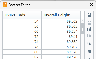

My query for the chart returns data for just one selected line, so the index numbers are sequential but some are missing since I’m not returning data for all lines. Like this:
 ![image](https://us1.discourse-cdn.com/inductiveautomation/original/3X/5/0/50826fb7b1880f2aad6602deebe735fef2f07d78.png)
I’ve tried to chart the data by treating the Index numbers as catagories. I config the X axis to be a catagory-type axis and configure that axis to be used in the dataset properties tab.
When I save that configuration I get the following errors:
_Invalid renderer type for dataset "Data" on chart "Chart 2". Please use XY renderer._
_Axis 'Catatory2' is the wrong type._
_It is a CategoryAxis and it must be a ValueAxis_
_ClassCastException: class org.jfree.chart.plot.PiePlot cannot be cast to class org.jfree.chart.plot.XYPlot (org.jfree.chart.plot.PiePlot and org.jfree.chart.plot.XYPlot are in unnamed module of loader java.net.URLClassLoader @a643a7b)_
I’ve also tried CAST and CONVERT on the Index number to convert it to a string in the chart dataset. When I do that I only get the last error ClassCastException.
I’m missing something in either the configuration or the dataset, but I can’t figure it out.
What am I missing here? Anyone have any suggestions?
**Post date:** [September 19, 2025, 4:04pm UTC](https://forum.inductiveautomation.com/t/invalid-renderer-type-for-dataset-on-chart/110752/2 "2025-09-19T16:04:11Z")
The 'Chart' component requires you to make a series of changes to properties if you're switching from XY to Category mode, or vice versa:
> **[Using the Classic Chart | Ignition User Manual](https://www.docs.inductiveautomation.com/docs/8.3/ignition-modules/vision/historian-in-vision/using-the-classic-chart#chart-type-xy-vs-category)**
> Chart

I’m so dense!
I was so focused on the query and the chart customizer that I forgot to change the chart type in the properties!!!
Thanks Paul, your reply was what I needed to find my error.
