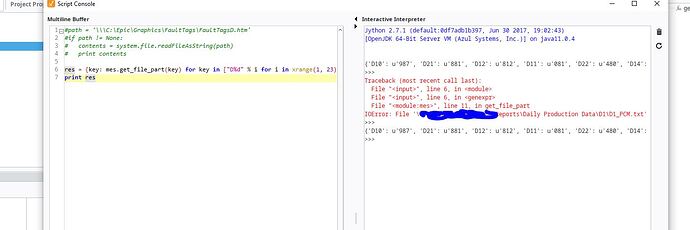

Sure you can.

Tested and working for HTM extension too

Don’t forget in your path to double up all your backslashes as seen in my attachment.

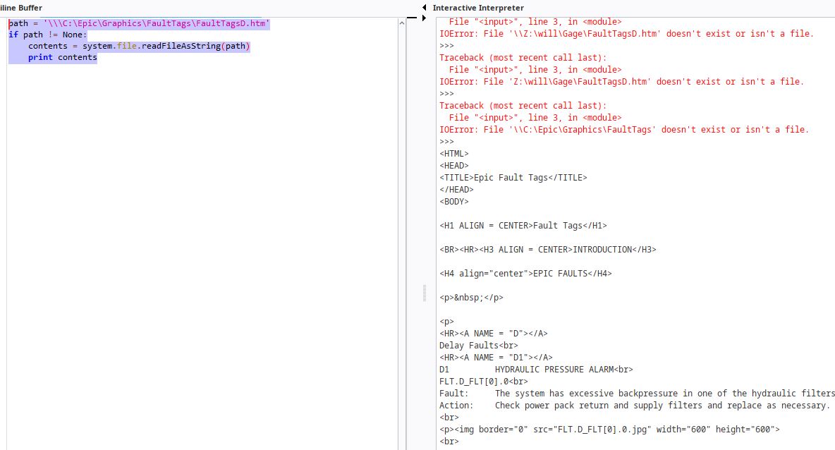

It is running on my local machine accessing my mapped drives on my local machine:
I did a bunch of work earlier thinking I was using the mapped drive of the server not paying a ton of attention to file paths. It was just working. I was confused as P: is Z: and vice versa… 🙄

To avoid this problem when hard coding the path, you could always use the \domain\folder\path style.
So instead of using P: or Z: you would have ‘//Domain\_or\_server/Folder/’ an example would be “\\EPIC-FILESVR\Shared\will\Gage\FaultTagsD.htm”
This is what I use as it guarantees you point to the correct location regardless of what machine it’s used on. You only have to make sure that the user running the script has rights to access the shared drive.

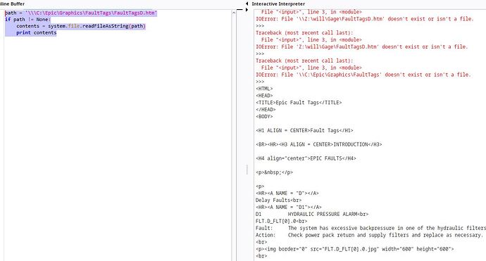

**Post date:** [January 17, 2020, 1:01am UTC](https://forum.inductiveautomation.com/t/is-it-possible-to-read-an-htm-or-html-file-as-a-string/31355/13 "2020-01-17T01:01:51Z")
Nice.
So that works from console nicely:
 ![1](https://us1.discourse-cdn.com/inductiveautomation/original/2X/9/9b19b422f13c0a11a9f0306bdd8b59b26312a78f.jpeg)
Can’t tell if it’ll work from gateway yet. Trying to figure out how to get my global scripting project to work. For that. Then I can confirm if the drive is mapped in ignition. One step at a time. Thanks man!
