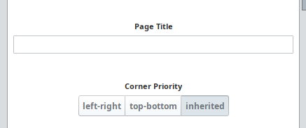

FWIW, is there a a way to make page title dynamic?
Like `tag("Sitename") + " Comissioning"`
Thank you.
 ![image](https://us1.discourse-cdn.com/inductiveautomation/original/3X/c/9/c9e26e27dbfa754ecb080917d479f53d4d75e13f.png)
**Post date:** [October 2, 2025, 2:03pm UTC](https://forum.inductiveautomation.com/t/is-there-a-way-to-make-page-title-dynamic/111157/2 "2025-10-02T14:03:20Z")
There's no binding button. So, no. (Even if you could, the `tag()` function is not the answer.)
But!
`page.props.title` is writable. So you could place a view custom property in a shared dock, use direct or indirect tag binding to subscribe to a desired tag, and use a property change event to make the title track the tag.

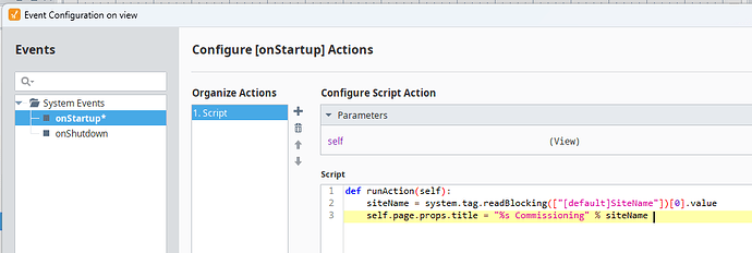

**Author:** ![Eugene49](https://avatars.discourse-cdn.com/v4/letter/e/c6cbf5/32.png) [@Eugene49](https://forum.inductiveautomation.com/u/Eugene49)\
**Post date:** [October 2, 2025, 2:09pm UTC](https://forum.inductiveautomation.com/t/is-there-a-way-to-make-page-title-dynamic/111157/3 "2025-10-02T14:09:08Z")
> [@pturmel](#):
Of course!
I owe you a beer!
 ![image](https://us1.discourse-cdn.com/inductiveautomation/original/3X/8/c/8cc325729cee6aad5041733b728c633c83726270.png)

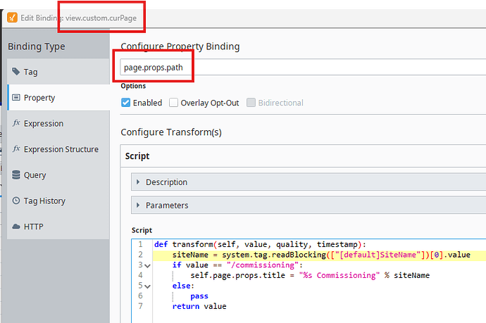

> [@pturmel](#):
Thanks again.
