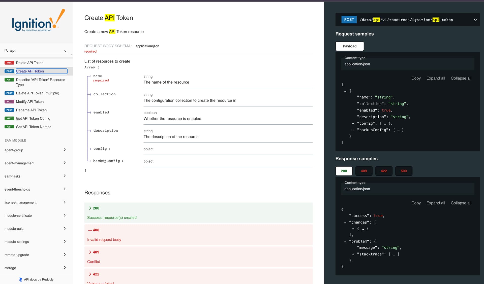

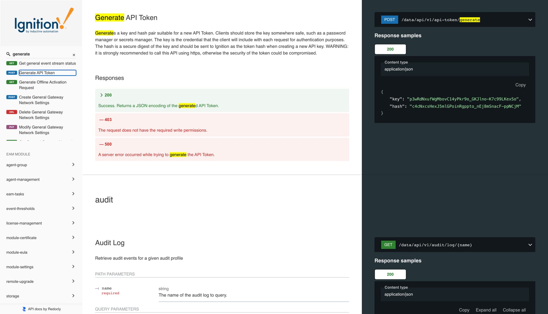

Hi, Is there a way to generate api token from rest api? I need to automate db connection setup after generating api key. I have portal setup and got username and password but not able to find curl request to login using username and password. Though I see generateToken and CreateToken in openapi doc but seems its there for additional API Token.
You can see api’s in screenshot attached.
 ![Screenshot 2025-08-14 at 2.56.28 PM](https://us1.discourse-cdn.com/inductiveautomation/original/3X/9/3/936ab4af6bf79126d045e6e7a4b3116d2f483715.jpeg)
 ![Screenshot 2025-08-14 at 2.56.43 PM](https://us1.discourse-cdn.com/inductiveautomation/original/3X/e/d/ed561d92844ccd3f9a1a5376c1ec567b31744155.jpeg)

You’ll want to POST against `/data/api/v1/api-token/generate`. This will return an object which contains a `key` and `hash`.
```python
    "key": "ABC",
    "hash": "DEF"
You’ll then need to POST against `/data/api/v1/resources/ignition/api-token`, and include the `hash` from the previous request within the `config.settings` object.
```python
    "name": "MyNewAPIKey",
    "collection": "core",
    "enabled": true,
    "description": "",
    "config": {
        "profile": {
            "type": "basic-token",
            "secureChannelRequired": false,
            "securityLevels": [
                    "name": "Authenticated",
                    "description": "Represents a user who has been authenticated by the system.",
                    "children": []
            "timestamp": 1755186044603
        "settings": {
            "tokenHash": "DEF"

but the ask here was to “curl request to login using username and password”, you cant connect to the endpoint “/data/api/v1/api-token/generate” unless you have an auth token, it wont accept username and password?
**Author:** ![cmallonee](https://sea1.discourse-cdn.com/inductiveautomation/user_avatar/forum.inductiveautomation.com/cmallonee/32/6416_2.png) [@cmallonee](https://forum.inductiveautomation.com/u/cmallonee)\
**Post date:** [December 29, 2025, 4:12pm UTC](https://forum.inductiveautomation.com/t/is-there-way-to-create-generate-api-token/109761/8 "2025-12-29T16:12:54Z")
No, the 8.3 API does not accept a username:password combination. The solution posted here assumes you have already created an API Key with Write permissions, and are using that API Key to automate creation of further API Keys.
