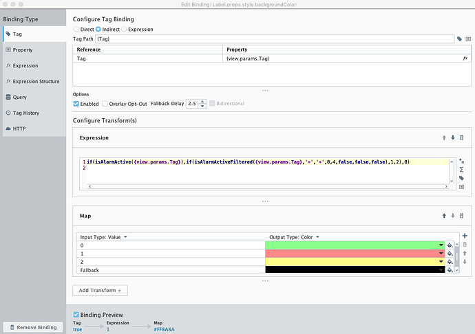

**Author:** ![cmallonee](https://sea1.discourse-cdn.com/inductiveautomation/user_avatar/forum.inductiveautomation.com/cmallonee/32/6416_2.png) [@cmallonee](https://forum.inductiveautomation.com/u/cmallonee)\
**Post date:** [June 9, 2021, 5:08pm UTC](https://forum.inductiveautomation.com/t/isalarmactive-and-isalarmactivefiltered-not-automatically-updating-color-binding-in-perspective/47607/2 "2021-06-09T17:08:27Z")
I think expressions only execute when a value within them changes. Since `{view.params.tag}` is not actually changing value, the expression will not update.
I would indirectly bind against the tag value, then I would use your expression in a transform with NO changes, and then I would include the Map transform _again with no changes_. In this way, the value will update whenever the tag value changes, and then evaluate whether or not the alarm is active.
 ![Screen Shot 2021-06-09 at 10.07.26 AM](https://us1.discourse-cdn.com/inductiveautomation/original/3X/3/5/35491626e8a54c2012bca46fdfa074f5653b768c.png)
When I tested this setup locally my label's background updated whenever the tag value updated.

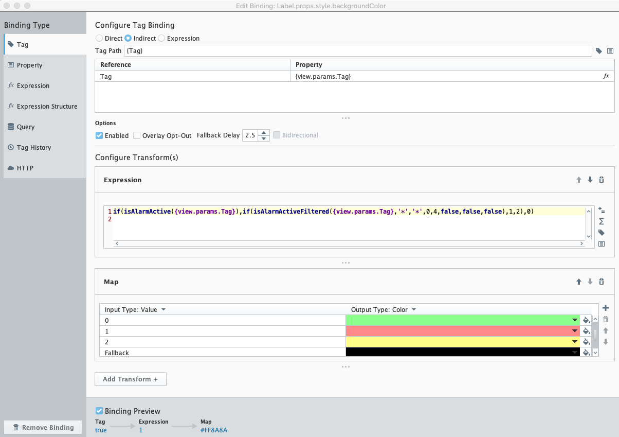

**Post date:** [June 9, 2021, 8:17pm UTC](https://forum.inductiveautomation.com/t/isalarmactive-and-isalarmactivefiltered-not-automatically-updating-color-binding-in-perspective/47607/5 "2021-06-09T20:17:17Z")
> [@BCNoyes](#):
> but not on the Ack
Ah, yes, you're right. I suspect this is now going to require some changes to your expression unless someone has a better way.
This is my solution, but it requires that you also supply the name of the alarm in use for the tag. This solution also make the original solution even easier because you are now binding against the alarm itself instead of the tag value and then an evaluation of the alarm states. You might need to safeguard against the potential of this view being passed a tag path which does not have an alarm configured.
1. I would make a custom property on the View: `isAcked`.
2. I would then bind this property directly to the `isAcked` property of the specified alarm via an indirect tag binding where you also supply the name of the alarm.
3. I would make a custom property on the View: `isActive`.
4. I would then bind the `isActive` custom property to the same property of the specified alarm.
5. You should now bind the `backgroundColor` property of the Label to an Expression Structure; this will allow you to re-evaluate whenever any of multiple properties change. You'll want two entries in your expression structure - one for each of the custom properties on the view.
6. Prior to 8.1.8, expression can become difficult to use after expression structures, so I recommend a script transform, followed by your Map transform.
Custom property which is bound to the actual properties of the alarm in use:
 ![Screen Shot 2021-06-09 at 1.14.30 PM](https://us1.discourse-cdn.com/inductiveautomation/original/3X/a/3/a344e4e91f66d113809e1eee41fce16db775ff30.png)
Label binding for backgroundColor:
 ![Screen Shot 2021-06-09 at 1.15.34 PM](https://us1.discourse-cdn.com/inductiveautomation/original/3X/e/8/e8bd30972a2a136ed815ad188a6b7d487bb07181.png)
