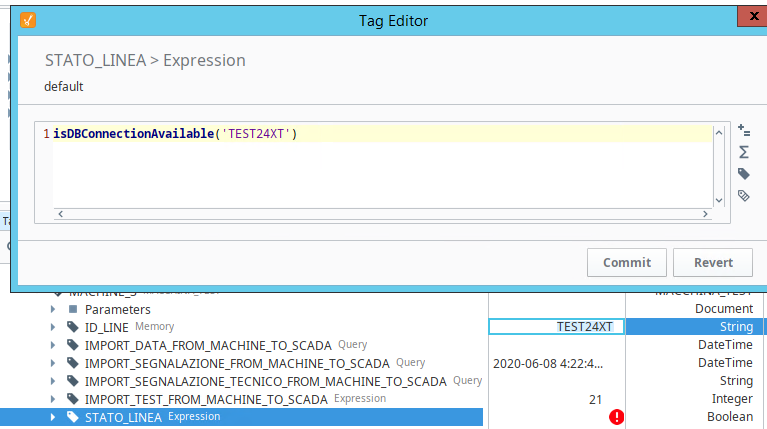

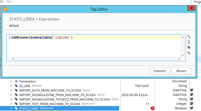

Greetings,
we found an issue on an expression tag whenupgrading from Ignition 7.9 to 8.0.12: our tag check the connection on a linked DB using the expression isDBConnectionAvailable, this formula was working in 7.9 but not in 8.0.
The Diagnostic of the tag says “Unknown function: isDBConnectionAvailable”, even if we try to retrieve the DB name by Tag, with apex or putting the DB name in parenthesis. To avoid syntax errors, i tried to copy the function using the tooltip, but that didn’t work too
I’m attaching screenshots of the error and of our configuration, the tag
is “STATO\_LINEA”.
Thanks a lot for every reply
 ![DBConnected](https://us1.discourse-cdn.com/inductiveautomation/original/2X/5/531ce43b4c548e14c404cdc965768a0165cb2b45.png) ![DBName](https://us1.discourse-cdn.com/inductiveautomation/original/2X/6/62e9a6bfcbde47849160945f46f90e092ae9cc15.png) ![Error](https://us1.discourse-cdn.com/inductiveautomation/original/2X/4/49de5ca2053fb465e646354b412e9b3dd881451d.png) ![FromDataType](https://us1.discourse-cdn.com/inductiveautomation/original/2X/4/49ffa0ffc0551029f4eb9ce0c6423d0a856231f6.png) ![WithoutApex](https://us1.discourse-cdn.com/inductiveautomation/original/2X/1/113b7a99bf19be88820258723ed70c1ca06b010f.png)

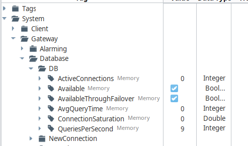

![image](https://us1.discourse-cdn.com/inductiveautomation/original/2X/1/1e57a5e7d864a1e1cd7888a06e14252a3027e39c.png)
How about using the system tag instead ?

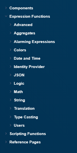

Also, that may be because it does not exists in 8.0
This is 8.X user manual,
 ![image](https://us1.discourse-cdn.com/inductiveautomation/original/2X/0/066f51fdcb74ca0edeadfc4f4da1f8c15282e729.png)

Thanks Kaushik, that worked! 😃
the thing that really upsets me was that i could see the function available in the function menu, but then he says “unknown funcion”.
With this workaround we can check the connection, thanks!
