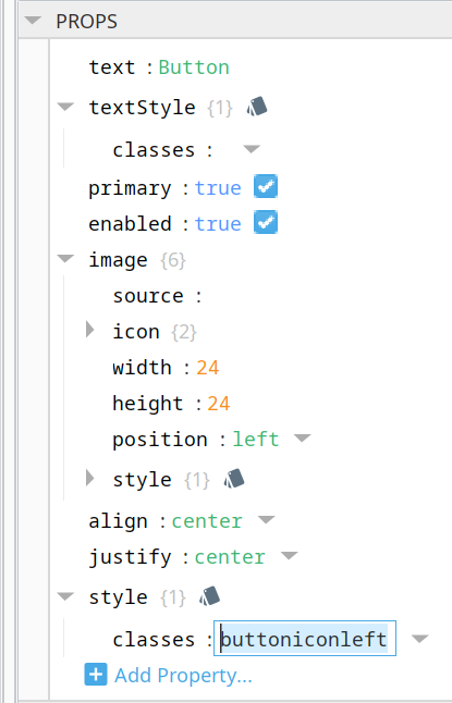

**Author:** ![dgillbee](https://sea1.discourse-cdn.com/inductiveautomation/user_avatar/forum.inductiveautomation.com/dgillbee/32/73838_2.png) [@dgillbee](https://forum.inductiveautomation.com/u/dgillbee)\
**Post date:** [September 25, 2025, 6:59am UTC](https://forum.inductiveautomation.com/t/issue-aligning-icon-to-the-left-in-button/110958/2 "2025-09-25T06:59:39Z")
Try this CSS to the advanced style sheet and selecting the style class `buttoniconleft` on the button.
```css
.psc-buttoniconleft .text { flex-grow: 1; }
/*Optional to make the icon not hard pressed against the edge*/
.psc-buttoniconleft svg { margin-left: 10px; }
 ![image](https://us1.discourse-cdn.com/inductiveautomation/original/3X/5/6/56e5ff685b3685b79f0acdd583e40cc51df73593.png)
 ![image](https://us1.discourse-cdn.com/inductiveautomation/original/3X/c/d/cdd552d7af8a8035a971f8aab69379091a1b9864.png)

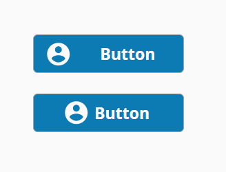

**Author:** ![TechEnlive](https://avatars.discourse-cdn.com/v4/letter/t/3be4f8/32.png) [@TechEnlive](https://forum.inductiveautomation.com/u/TechEnlive)\
**Post date:** [September 25, 2025, 9:00am UTC](https://forum.inductiveautomation.com/t/issue-aligning-icon-to-the-left-in-button/110958/8 "2025-09-25T09:00:12Z")
Thank you very much for your help! @dgillbee
I followed the @pascal.fragnoud instructions and implemented it as suggested. Now it works exactly as we wanted.
 ![image](https://us1.discourse-cdn.com/inductiveautomation/original/3X/8/7/87a19d015f4e97897de3f702d3fb06ecfe449762.png)
