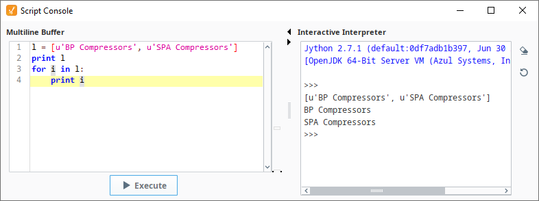

**[u’BP Compressors’, u’SPA Compressors’]**
i need to remove **u** from the list . please let me know how to remove the **u**
**Post date:** [February 19, 2021, 4:41pm UTC](https://forum.inductiveautomation.com/t/issue-in-split-list/43628/2 "2021-02-19T16:41:25Z")
The u just means it’s unicode. It’s not part of the string itself.
 ![image](https://us1.discourse-cdn.com/inductiveautomation/original/3X/3/9/3935abef5bd85b86a5b9c65439788d3f6c6c0a8f.png)
