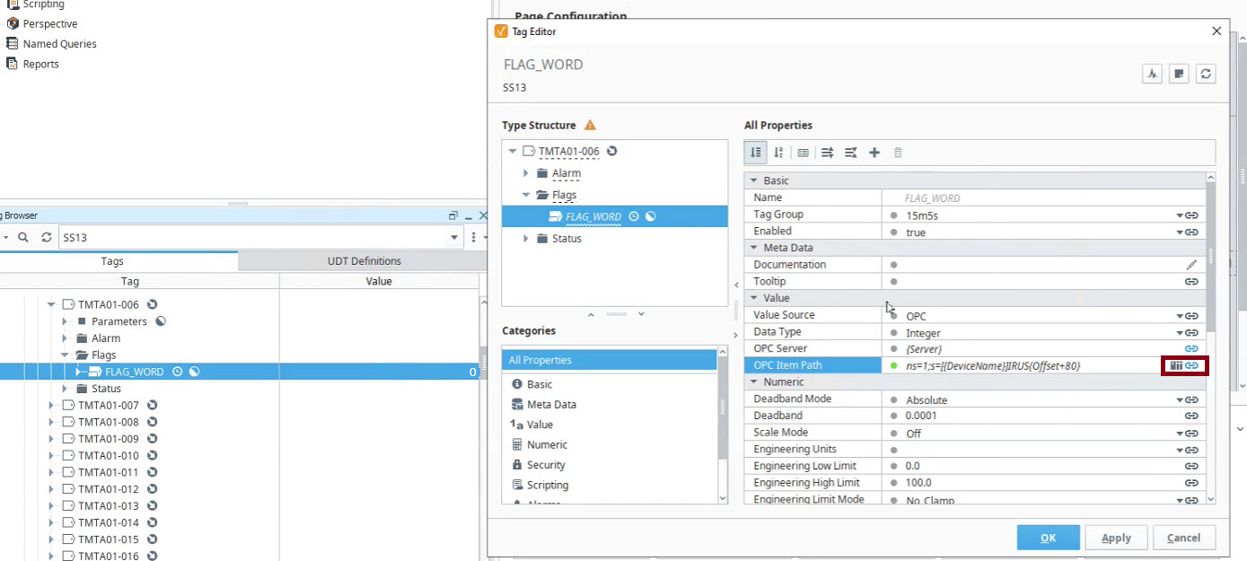

I'm encountering a strange behavior when trying to update the OPC item path of a member tag inside UDT instances using `system.tag.configure`. Here's my script:
```python
base_path = '[SS13]TECO/Trackers/'
paths = system.tag.browse(base_path, {'name': 'TMT*', 'recursive': True, 'tagType': 'UDTInstance'})
for path in paths:
    tags = str(path['fullPath']) + '/Flags/'
    newOPC = 'ns=1;s=[DeviceName]IRUS{Offset+80}'
    config = {
        "name": "FLAG_WORD",
        "opcItemPath": newOPC
    system.tag.configure(tags, [config], 'm')
    print tags
The script successfully updates the `opcItemPath` for each tag, and I can see the new tagPath in the designer. However, the tag stops working, and shows the Error\_Configuration. It only starts working again after I manually edit the tag in the designer (for example, changing the tag path slightly and then changing it back).
Before changing the tag path
 ![Screenshot 2025-07-16 152007](https://us1.discourse-cdn.com/inductiveautomation/original/3X/5/5/55f29822e8762487893812175f1dc5741b00f2f0.jpeg)
After changing back
 ![Screenshot 2025-07-16 152021](https://us1.discourse-cdn.com/inductiveautomation/original/3X/e/9/e9612df3c48c8000f6c30f9ea81f513b82b3f4f0.jpeg)
I have over 2,000 tag instances that need to be updated, so doing this manually is not feasible.
Also, I can't create new UDT definitions due to project restrictions.
Has anyone experienced similar issues or know a workaround to make the changes take effect immediately without breaking the tag binding?
Thanks in advance for your help!
**Post date:** [July 16, 2025, 7:09pm UTC](https://forum.inductiveautomation.com/t/issue-updating-udt-opc-item-path-via-system-tag-configure-binding-breaks-until-manual-edit/108568/2 "2025-07-16T19:09:05Z")
When a tag property value includes a parameter reference, you cannot just assign the string value with the curly braces embedded. You must expand that value to a binding dictionary for the expression to "stick". Export a working sample to JSON and inspect it to see the difference.
