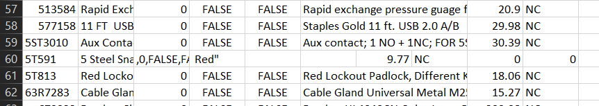

If you open your csv file in excel, row 60 seems messed up:
 ![image](https://us1.discourse-cdn.com/inductiveautomation/original/3X/9/7/97d89f4cb0ab6a7b6adac0dd90487539e4fdfe09.png)
Looking at it in a text editor:
 ![image](https://us1.discourse-cdn.com/inductiveautomation/original/3X/8/d/8d7e38d8de12c5beb1fd3fd7705a6122664c2f84.png)
There’s something weird going on with that row… Perhaps that is what is messing it up?

Completely removed that row, still getting the same error though.
