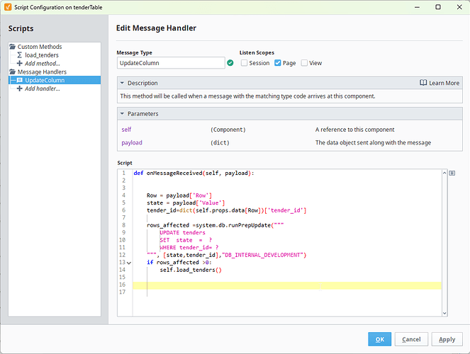

Hello everyone,
I'm encountering a problem with the embedded view state not updating correctly when rows are removed from a table.
Here are the details:
## Current Setup
- The table includes a dropdown column, which is an embedded view.
- Users can select "Hide" from this dropdown.
- When "Hide" is selected, the row number and state column value are sent for updating.
## Process

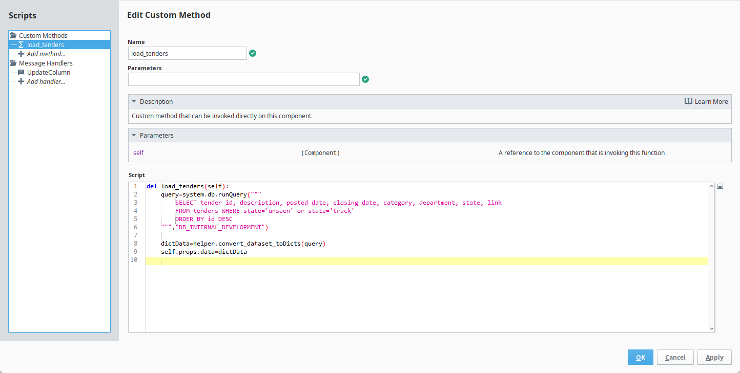

1. An update query changes the row's state value in the database.
2. The table is then queried to retrieve the updated data.
## Issue
The embedded view state doesn't seem to update correctly when the state is changed to "hide," even though the props data is accurate. This occurs despite the `load_tenders` function filtering out the hidden rows.
Ignition Gateway version: **8.1.45 (b2025010709)**
 ![image](https://us1.discourse-cdn.com/inductiveautomation/original/3X/f/6/f6790ee3b6d3757648301a674be2b0d8b4f1b927.png)
 ![image](https://us1.discourse-cdn.com/inductiveautomation/original/3X/c/7/c792a97c0fbb0a7554d43918e3f0508936a1aec6.png)
