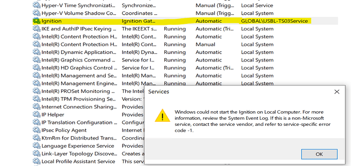

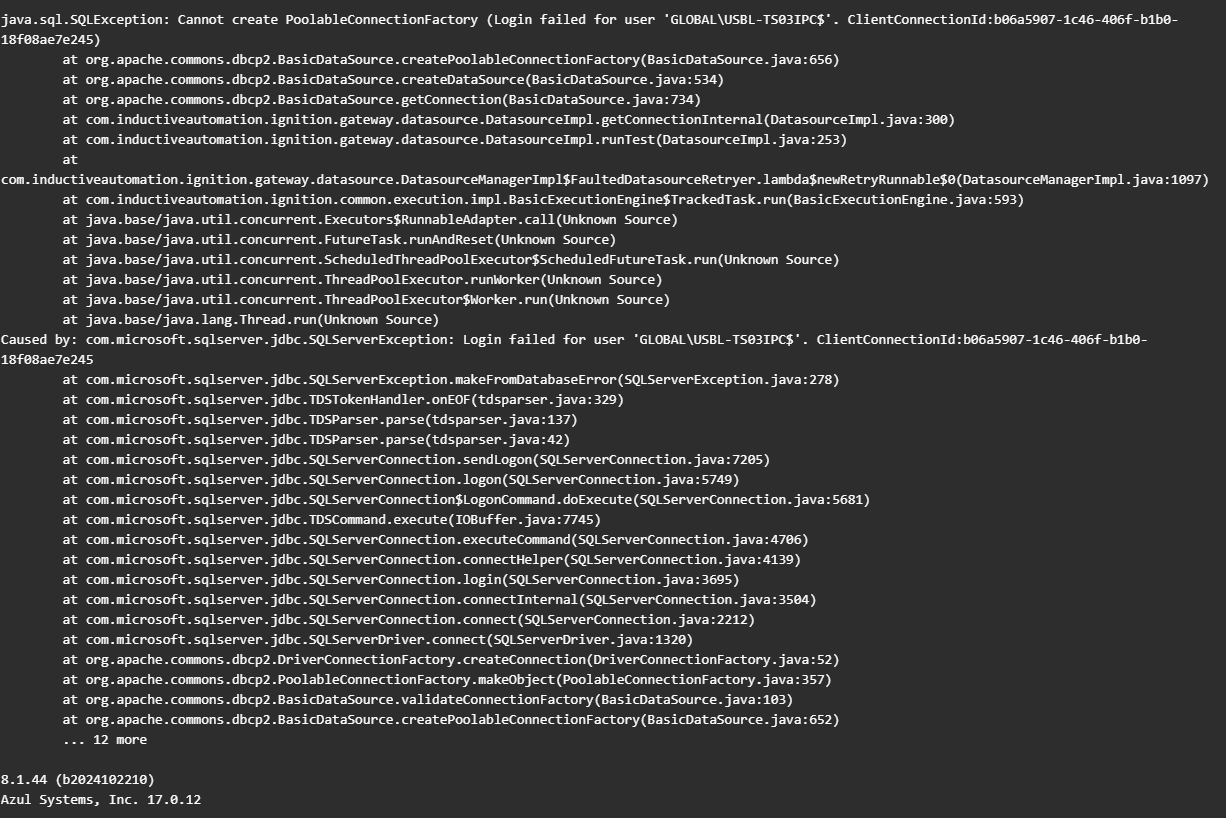

I am trying to connect to an MSSQL server using Windows Authentication. Here is a summary of the issues I have ran into.
Initial Error:
 ![image](https://us1.discourse-cdn.com/inductiveautomation/original/3X/f/6/f6a3c98782f3b043f2bc65caf73e393e51b0d4e9.png)

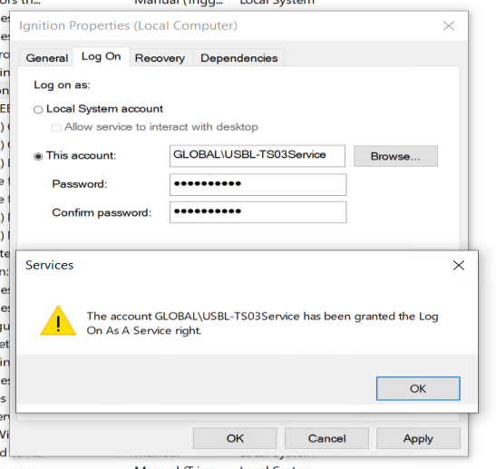

That resulted in these new issues.
 ![WindowsUser](https://us1.discourse-cdn.com/inductiveautomation/original/3X/0/6/068b2c1a3ebdafbce1a377cd44b66b6b5aa26aa6.png)
 ![ServiceStartError](https://us1.discourse-cdn.com/inductiveautomation/original/3X/3/d/3d704f107903a9906fab833054c9c907032ca760.png)

Lastly, I am able to connect to the database directly from the operating system, but not from Ignition, so I don't think it is a windows Issue.
If anyone has any ideas on how to resolve this or a path forward, it is greatly appreciated.
**Author:** ![tgarrison](https://sea1.discourse-cdn.com/inductiveautomation/user_avatar/forum.inductiveautomation.com/tgarrison/32/80965_2.png) [@tgarrison](https://forum.inductiveautomation.com/u/tgarrison)\
**Post date:** [July 24, 2025, 4:05pm UTC](https://forum.inductiveautomation.com/t/issue-with-ignition-connecting-to-mssql-server/108899/2 "2025-07-24T16:05:53Z")
#4 in that report is key. Work with your IT dept to figure out why it isn't able to run the Ignition Service using that account.

Hi @William_Gibson Did you ever fix this? I have exact same situation right now.
**Author:** ![Daniel\_Calderon](https://avatars.discourse-cdn.com/v4/letter/d/51bf81/32.png) [@Daniel\_Calderon](https://forum.inductiveautomation.com/u/Daniel_Calderon)\
**Post date:** [October 8, 2025, 3:57pm UTC](https://forum.inductiveautomation.com/t/issue-with-ignition-connecting-to-mssql-server/108899/4 "2025-10-08T15:57:40Z")
Fixed it. IT made the service account able to run services on the server PC.
