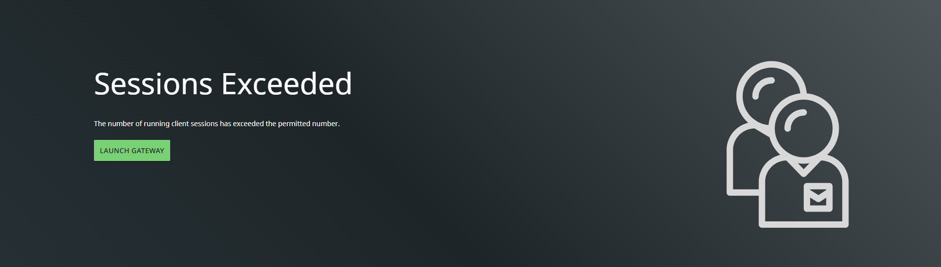

We recently purchased an Ignition Edge license. I’m experiencing issues regarding the number of available sessions with the license.
Whenever I try to open the single available Perspective project in a web window, I receive the message shown in the image below.
The problem occurs even when only the Designer is open, and it persists even after closing the Designer with only one web window open.
Has anyone else had this problem?
 ![image](https://us1.discourse-cdn.com/inductiveautomation/original/3X/7/5/75a7090a81f2f38e827534ecc3732c7b160acb02.jpeg)
**Author:** ![avaughn](https://sea1.discourse-cdn.com/inductiveautomation/user_avatar/forum.inductiveautomation.com/avaughn/32/38972_2.png) [@avaughn](https://forum.inductiveautomation.com/u/avaughn)\
**Post date:** [November 18, 2025, 5:55pm UTC](https://forum.inductiveautomation.com/t/issue-with-ignition-edge-perspective-session-limit/112258/2 "2025-11-18T17:55:29Z")
Do you have the Visualization Module set to Perspective?

No, but that solves it, thanks!
