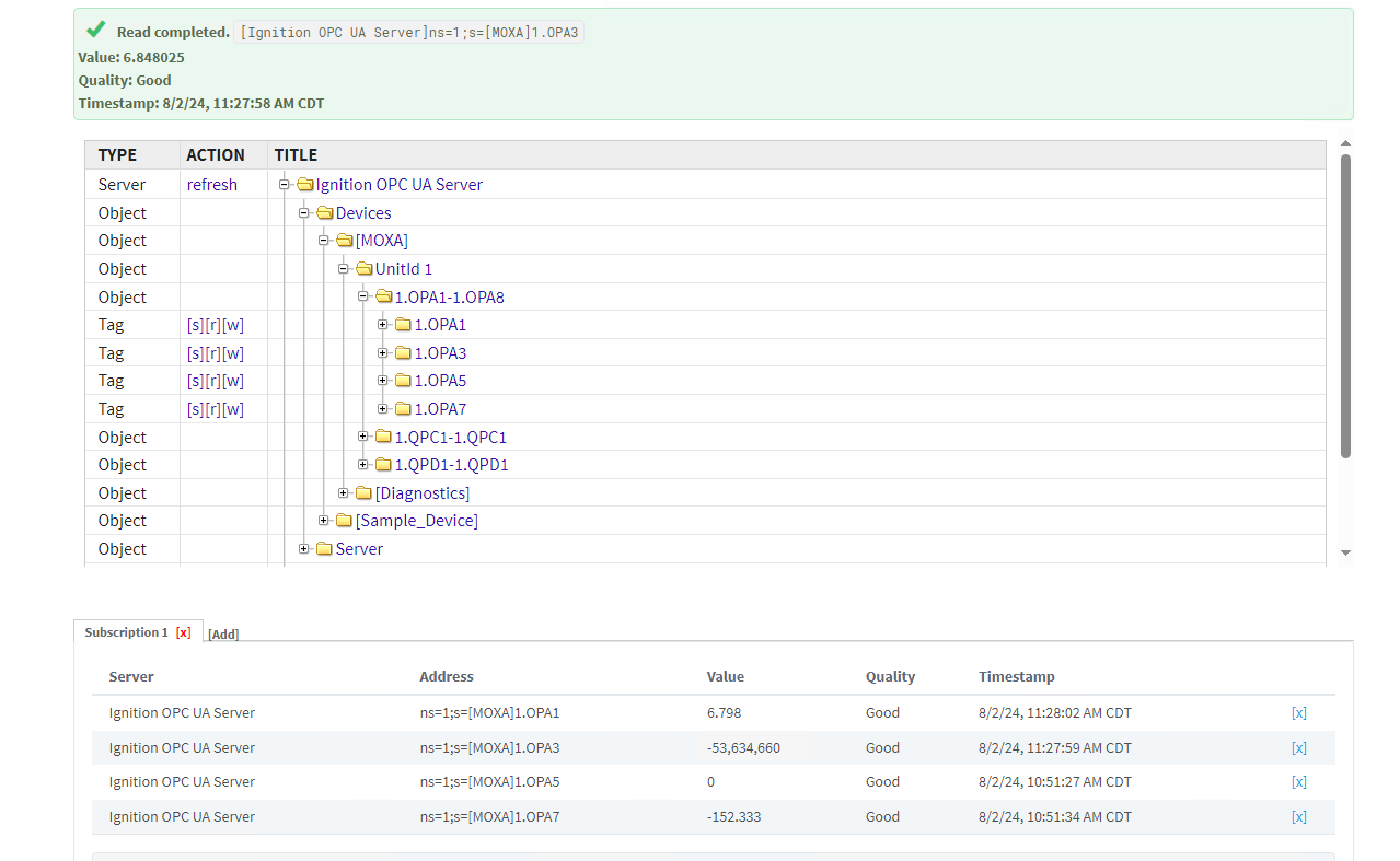

What can cause this? Read shows correct values but subscribe is not?
 ![image](https://us1.discourse-cdn.com/inductiveautomation/original/3X/2/c/2ca7e21f6a3834083b9be1edd7e1883ef651ed9f.png)
**Post date:** [August 2, 2024, 3:26pm UTC](https://forum.inductiveautomation.com/t/issue-with-modbus-data/94118/2 "2024-08-02T15:26:08Z")
Maybe start with a Wireshark capture.
It would also be useful to see your Modbus Address mapping configuration (though I recommend you don't use that at all if you can avoid it).

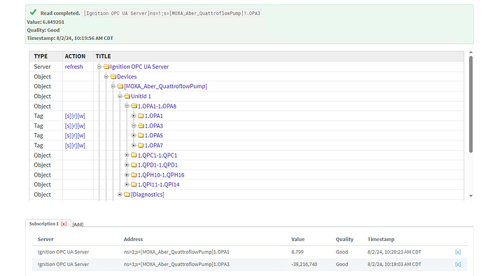

![image](https://us1.discourse-cdn.com/inductiveautomation/original/3X/0/c/0c01271f9b055889672600e4b2d3d37a88bab8a5.png)

**Post date:** [August 2, 2024, 4:18pm UTC](https://forum.inductiveautomation.com/t/issue-with-modbus-data/94118/8 "2024-08-02T16:18:02Z")
I don't see anything strange, but in this capture the single read you did looks to have been for "OPA1" and not "OPA3" like in your screenshot.

I clicked on both tags reads in this

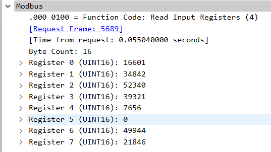

**Post date:** [August 2, 2024, 4:24pm UTC](https://forum.inductiveautomation.com/t/issue-with-modbus-data/94118/10 "2024-08-02T16:24:13Z")
Your device seems to return different data for the same registers depending on how many overall register are being read.
Reading Input Registers 0-7:
 ![image](https://us1.discourse-cdn.com/inductiveautomation/original/3X/9/b/9b9f94014d4ff209d0bda0fa6d82f6b8066e7231.png)
Reading Input Registers 2-3:
 ![image](https://us1.discourse-cdn.com/inductiveautomation/original/3X/8/0/808c6c4e38d351631fc4a47cf097056fbea46731.png)
Note the different values returned for 2 and 3 between the two screenshots...
Seems like you should be talking to the vendor of this device about its buggy implementation.

Ok. What is the reason for change in values when we click on 'read' and 'subscribe' ?
 ![image](https://us1.discourse-cdn.com/inductiveautomation/original/3X/7/e/7e76b49186aa768cfb523c4b78a832bbb01023fb.png)
**Post date:** [August 2, 2024, 4:34pm UTC](https://forum.inductiveautomation.com/t/issue-with-modbus-data/94118/12 "2024-08-02T16:34:57Z")
When you click Read it sends a request for just the 2 registers needed for that tag.
With your subscribed tags, all 8 of the sequential registers needed are bundled into a single request.

I split the definition into multiple address mapping categories and that seemed to work.
